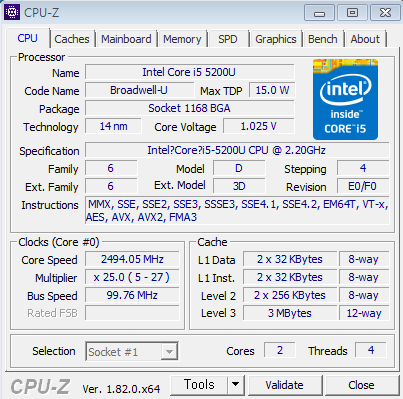

    What are the hardware specs of your machine?
