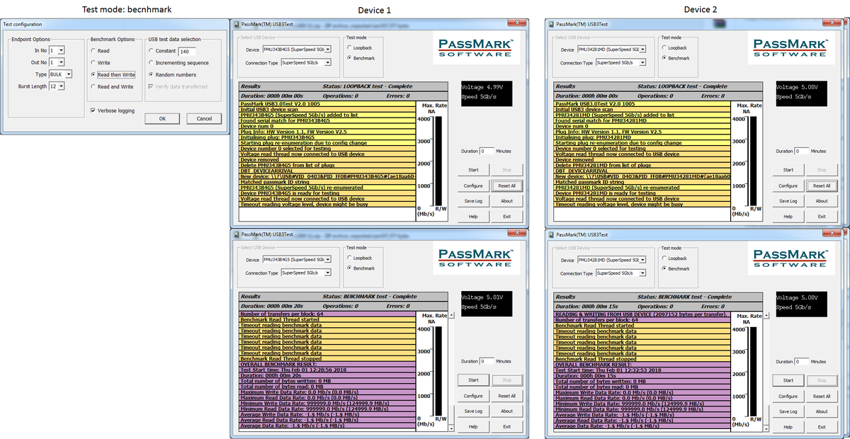

    Using the USB 3.0 Loopback Plugs and USBTest Software under Windows , the log application shows: Timeout reading benchmark data during Benchmark mode testing. The results are similar in two different devices. Attached two picture showing the configuration used and the results.

    Please, refer to benchmark configuration and results here.

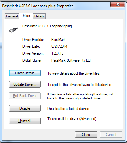

        • Driver version. The device driver is up to date.

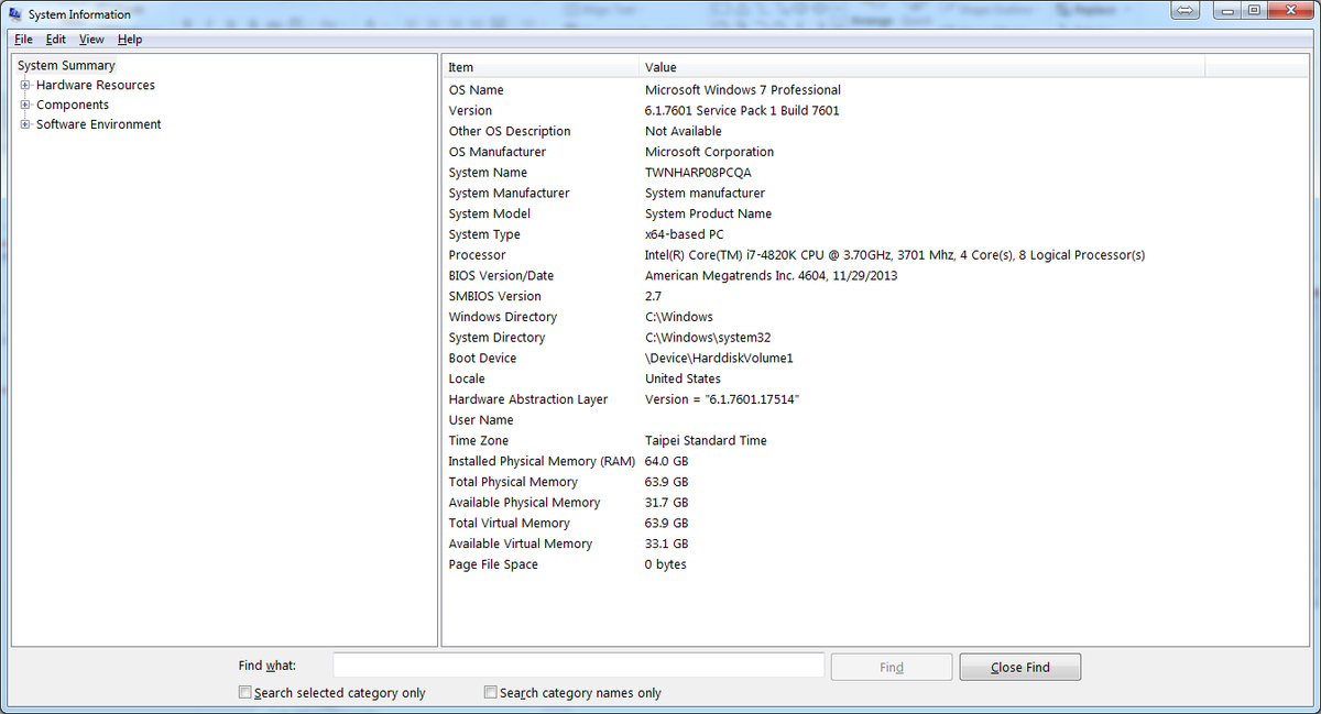

        • The PC is running Windows 7 64bits, CPU Intel i7, 64GB memory. Details specs attached.
