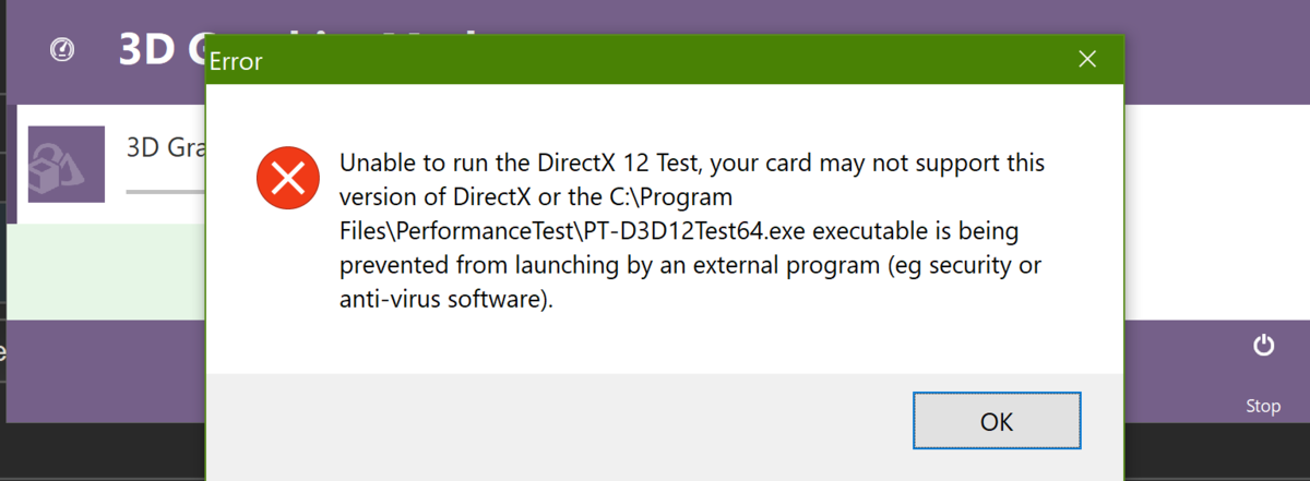

    I'm using passmark to benchmark a new laptop with latest specs. I've updated to latest drivers using Geforce Experience. When, I run the 3D benchmark the DirectX 12 Test fails, after about 3 secs (everything else works). I can see a scene with space ships shown, and it stops in the middle. Surely, the card supports the latest graphics stuff. Any idea what's going on? I'm yet to install a few games, as I run passmark to check for obvious issues, but I'm going to do that now and check.
    Click image for larger version  Name:	passmark-error.PNG Views:	25 Size:	102.1 KB ID:	45089
    Error text: Unable to run the DirectX 12 test, your card may not support this version of DirectX, or the executable is being prevented from launching by an external program.

      I got the same problem too with my laptop MSI GL73 with RTX2060 .. I think its is the overlay option in Geforce Experience cause the problem. I disable it and restart and its fine now..or if wanna make sure just exit the nvidia control and geforce experience don't let it run in background when using the Performance test .. Good luck everyone. Thank you.

          I have solved the problem by going to the task manager and end task all the nahimic processes. And the Performance test went smoothly now .. I Don't know who to report this bug too ... Good luck and enjoy your RTX2060
