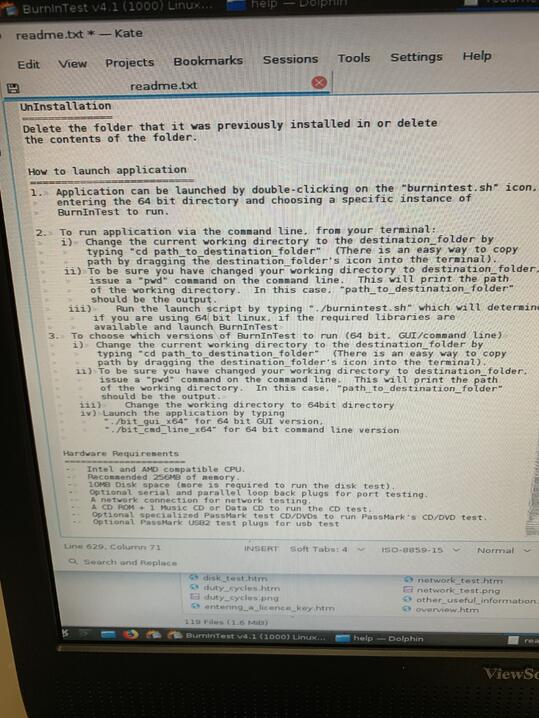

        Update: I did find the readme.txt file thats in the attached picture which calls out instructions for running Burnin from the command line.
        Command: ./bit_cmd_line_x64

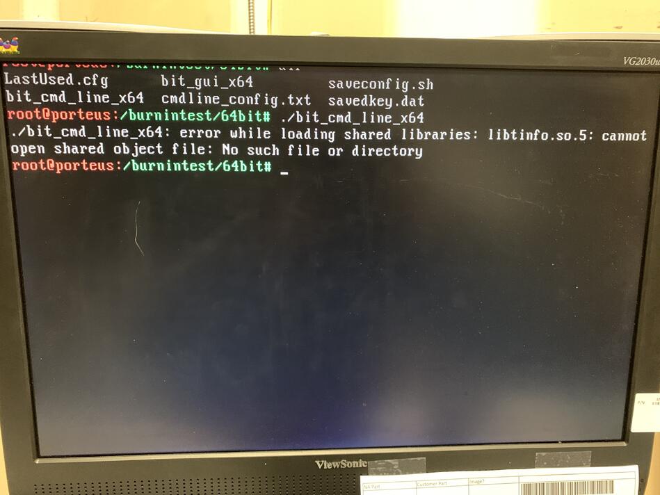

        When I run it, I get the error: error while loading shared libraries: libtinfo.so.5:cannot open shared object file: no such file or directory
        Any further direction I might be able to try?
        Appreciate the help.
          • 969
          You can check the FAQ question for the standalone BurnInTest Linux to see if you can locate the libtinfo.so.5 file.
          Q. I am getting "error while loading shared libraries: libxxx.so.x: cannot open shared object file:
          No such file or directory?" error when I launch BurnInTest Linux from the command line, why?
          But this may be related to the above comment where we haven't setup/tested the command line only mode from the Bootable USB Flash drive, so likely some required scripts wouldn't be executed so BurnInTest might not run without some changes. If you are unable to get it to work, then the best person to look at this is located in our Australia Head Office and he may have input on Monday.
