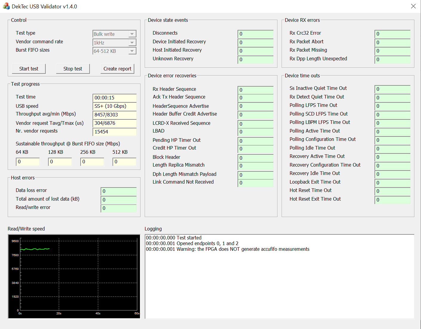

                    Yes. Some progress. We have a few different bits of prototype hardware to explore some solutions.
                    Some looked promising but ultimately weren't suitable. We looked at just doing a load testing device, that couldn't report any errors, for a while, but dismissed this as not being very useful.
                    But we have some prototype hardware now that does the job up to 10Gbit/s with a possible path to 20Gbit/s later on.
                    Very good speeds (after the overheads are taken into account) and also very good error reporting.
                    The prototype hardware was around $4000USD for the board. But this will come down a lot once we get to mass production.
                    Screen shot of it running is below.
                    But there is still a fairly long road to getting any hardware manufactured in bulk. So even assuming this solution ultimately fully works, it will still be several months before we have a product to sell.
