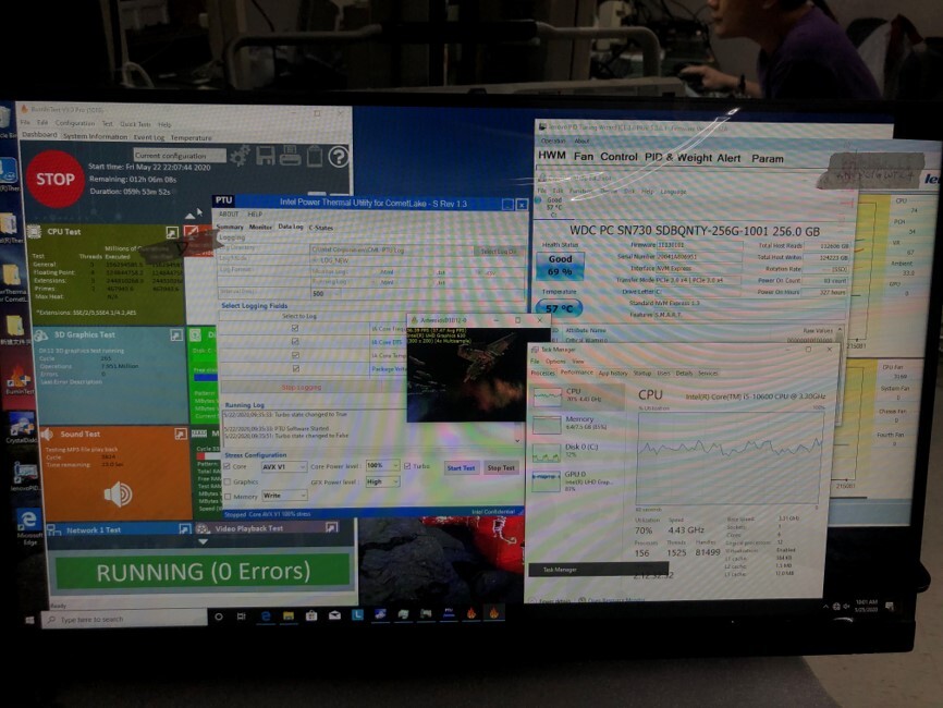

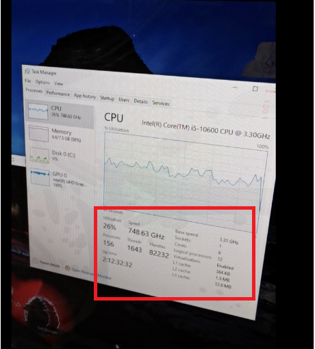

          I attach task manager picture.no1 is fail info , if we use mouse to click something, the task manager will change no.2 picture.
          event log show nothing.not only this 3 unit fail, other unit will fail. this issue is random. it seem like not KEY part issue.we
          change CPU, HDD, RAM , all conition still can repro. BTW, can we use pure OS to run burn in test, because we need to analyze that is driver issue or BIOS & EE issue.

              So if you can bring up task manger and the system responds to mouse clicks, then the system really hasn't locked up at all.
              Maybe it is just insanely slow. This can happen if there is a lot of swapping to disk, if the system runs out of RAM.But in this case the HDD LED should be on / flashing
