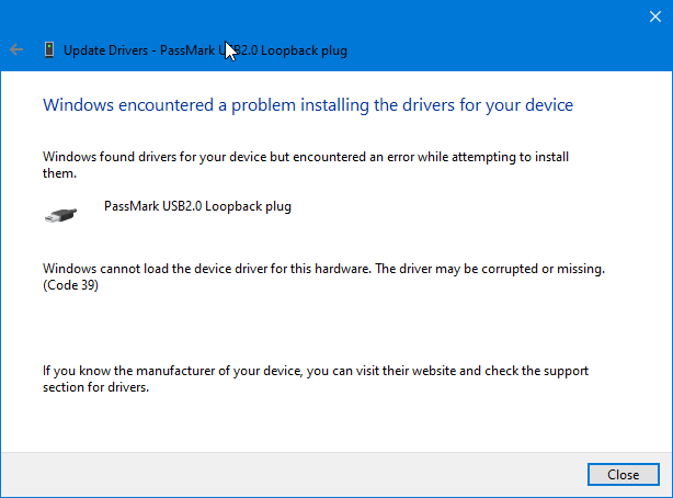

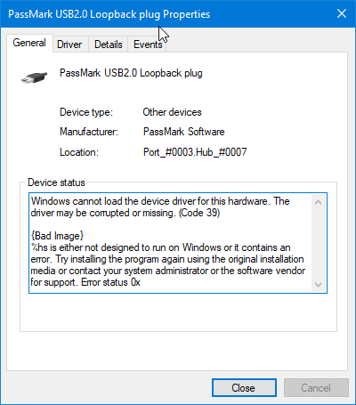

    I have one of your USB 2.0 Loopback Plug that I bought years ago (30 April 2004, Order #: U5729799). Not sure what Rev. it is, on back in only says Model: PMUSB02. I cannot get it to work on my Windows 10 computer (Windows 10 Pro 64bit all updates). When I install the drivers for it I get some I get some kind of driver is corrupted or not for Windows error. I have attached 2 pics of the error. I am not really sure if the USB 2.0 Loopback Plug works with Windows 10? I have one of your USB 3.0 Loopback Plugs and it works fine on the same computer. I have redownloaded the drivers twice. Thanks for any help.
    "Windows cannot load the device driver for this hardware. The driver may be corrupted or missing. (Code 39)"
    Click image for larger version  Name:	USB 2 LoopBack 2.png Views:	10 Size:	19.7 KB ID:	51342Click image for larger version  Name:	USB 2 LoopBack 1.png Views:	9 Size:	16.6 KB ID:	51343

      I tried both the 32bit and 64bit drivers. In fact it would not let me install the 32bit drivers. And yes, I am sure drivers the are for the USB 2 Plug. I downloaded them twice to make sure and that I did not get a corrupt download. The file name is usb2loopdriver_x64.zip. I did notice the drivers are kind of old, back from 2011. That's why I thought they did not work with Windows 10.

        I tried it on another computer and the driver loaded fine and the USB 2 Plug worked correctly. But I did fined out what the problem was. On the computer that the driver would not load correctly I had Memory Integrity turned on (Settings, Update & Security, Windows Security, Device Security, then Core Isolation). I turned that off and the driver loads fine. But I can't turn it back on without uninstalling the driver. I know it is not a very high priority, but maybe an updated driver someday.
