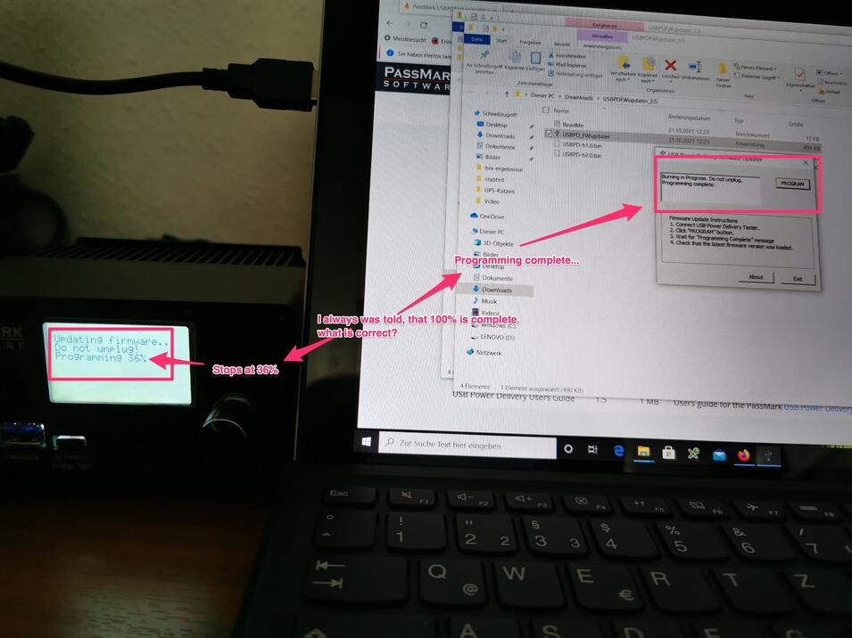

            This is what happens during the firmware update. people/glass houses/stones/throwing...
            What to do with the situation in the screenshot? Click image for larger version
ID:	51624 Remove USB and risk a brick?
            Seems thare is an issue... (Not with the USB charger...)
            Sorry to say this.
              • 11126
              Can you try on a different PC with a different USB cable. Might just be loose cable / port.
              Should be no risk of of bricking it.
              If the FW is corrupt however and you re-attempt, it might prompt you to pick firmware for PM110 (Revision 1) or PM125 (Revision 2) however.
