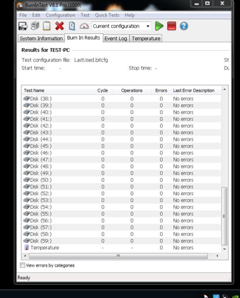

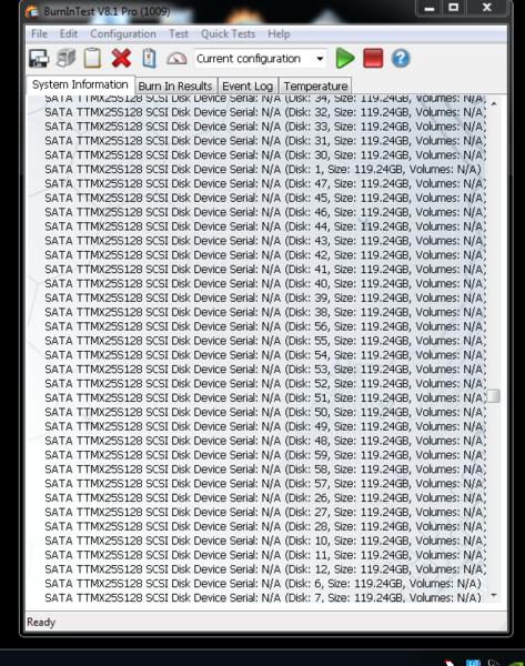

    Wow, it does work. See pics attached showing 59 drives ready for test. I will be running 80 drives early next week in case you need confirmation. One more thing though, notice on first picture that the S/N of the drives that was there on previous version 1008 is not there anymore(check pic on my posting number 9 where the serial number worked). Can you put it back? I meant, can you make the software change in a way that the serial number is shown and the drives still go over 50 units? Thanks

    replied
    I believe we were finally able to reproduce and fix this behavior, there is a new debug build available at http://www.passmark.com/ftp/bitpro8.1.1009.exe, could you please install this build and let us know how it goes.

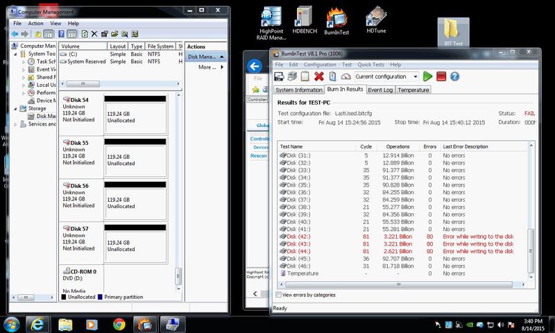

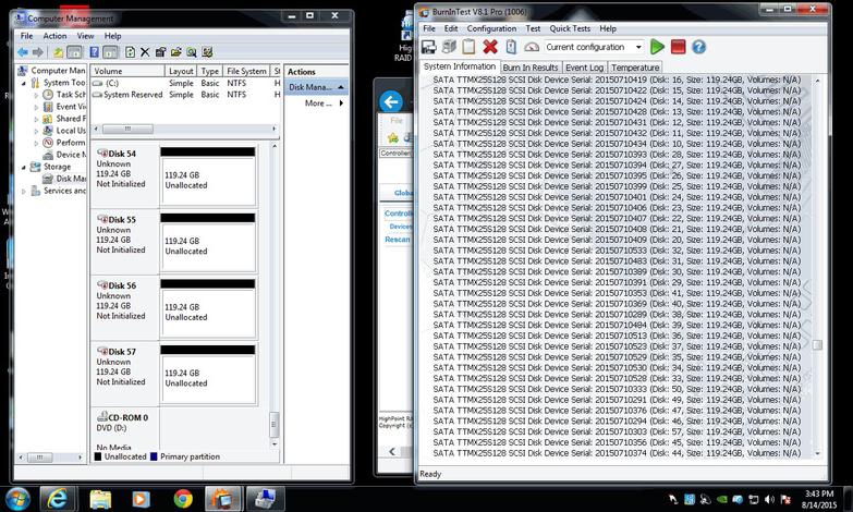

    OK, downloaded 8.1 PRO and loaded 57 drives on my computer. BIT nicely recognize the whole 57 drives(even by serial number) under "System Information" but under "Burn In" results it does not run any test after 50 drives. I attached a couple of pics and a Log in case you want to see it. You will notice that BIT will test 46 drives(i took out of testing my C and D drives) and A and B are off by default i think. A couple drives failed but that is my fault, i am fixing my fixture over the weekend. Is there anything i am doing wrong? Is there anyway of activating more than 50 for testing? Thanks
    It did not let me attach the Log but i guess you will get the idea from the pictures.

    The limit should already be above 50 (it is by con-incidence 80, in BurnInTest V.
    But to be honest we haven't tested it ourselves with 80 drives. So there might be an issue somewhere between 50 and 80 that we aren't aware of.
    I assume drive number 51 appears in Windows Explorer?
    Leave a comment:
