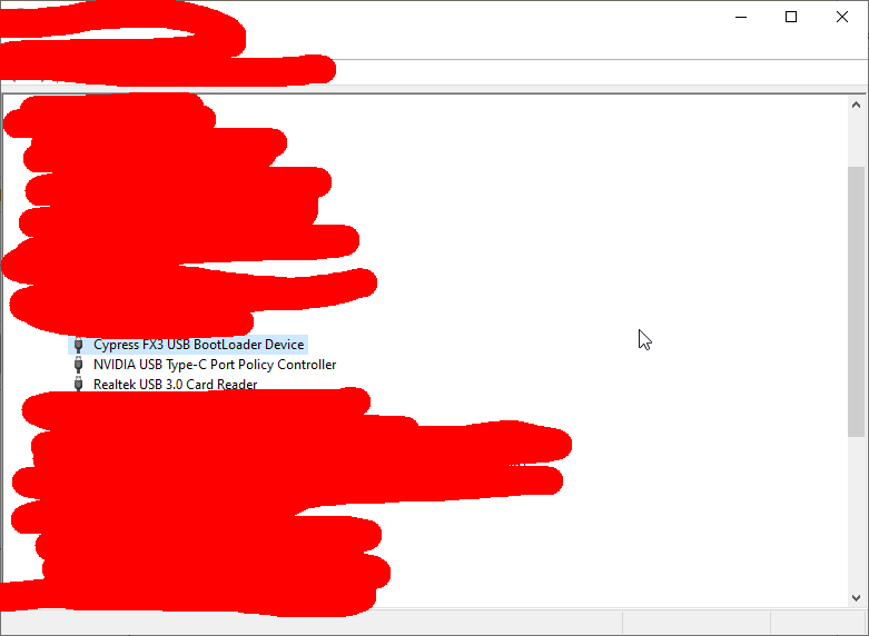

    Hello!
    When I tried to update USB 3 test plug (version 2), I got this error window. I tried on different PCs and with different cables. The result is the same. Is it possible to return the device to life or just buy a new one?

    If it is recognized as "Cypress FX3 Bootloader Device", it means the firmware is wiped out. Can you reload the firmware using the below updater tool?
    https://www.passmark.com/products/us...k/download.php

      Yes, it worked. After creating a folder in the root of the disk. Apparently the problem lay in the localization of windows. Thank you!
