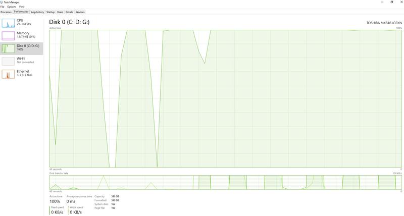

    I have been trying to diagnose a problem with my HP laptop since I upgraded it to Windows 10. A Problem developed that a whole lot of people are having. My hard drive activity goes up to 100% almost constantly with extremely long response times. I noticed while the SMART test is running on my hard drive, Windows performance monitor shows the active time and average response times return to normal until the SMART test completes. The hard drive shows no problems on any of the multiple tests that I have ran. Is it possible that the test is disabling something in windows that could be the cause of my problem? Thanks for any help on this

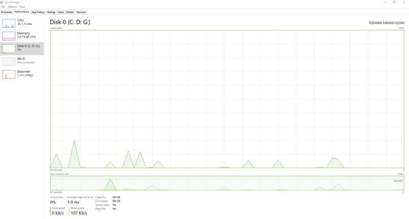

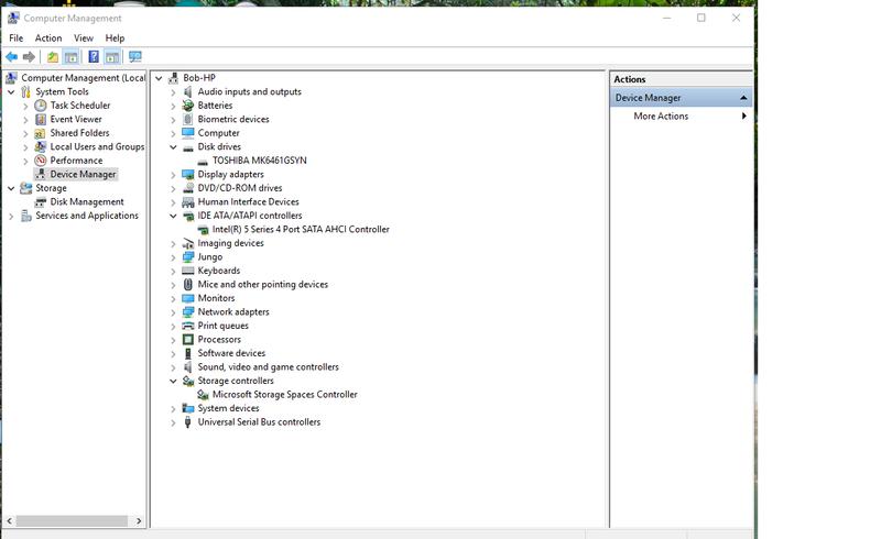

      This all started when I upgraded to Windows 10 from Windows 7. Here are some specs
      HP DV7T-4100 Core I7 (Quad core hyperthreaded-Monitor shows 8 processors)
      Turbo boost to 2.9ghz
      640GB HD 7200 rpm
      8GB DDR3 Ram
      Windows 10 64bit
      1gb ATI Radeon HD5650 DDR3 graphics
      This computer screams on Windows 7 and when the SMART test is running. Majority of the time the system lags and doesn't respond. All Drivers are up to date. Bios is up to date and doesn't give any options for AHCI but it is running in AHCI mode. Attached are some screen shots that may give some more info.
ID:	34959Click image for larger version
ID:	34960Click image for larger version
Name:	SMART test running.jpg
