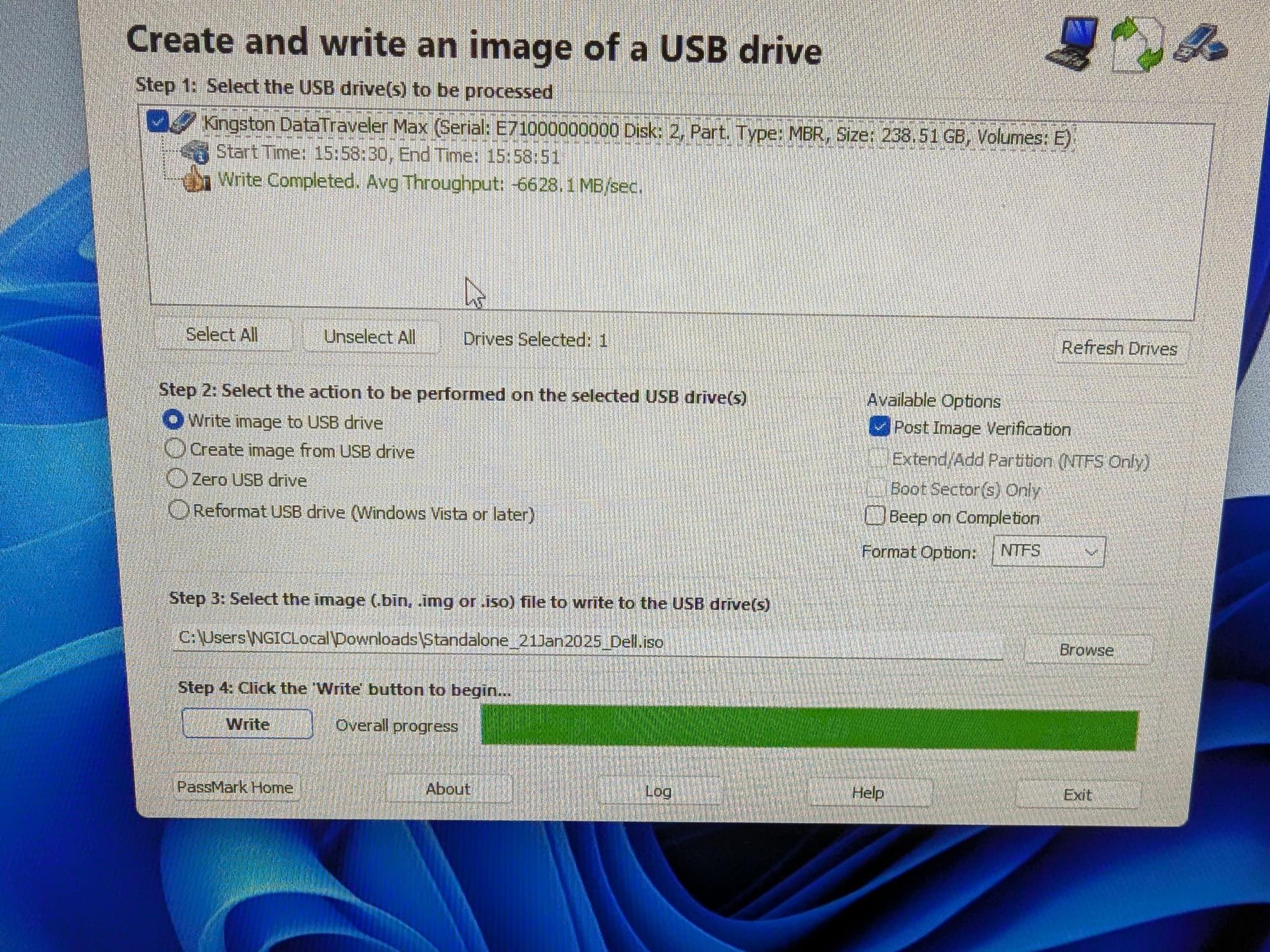

              Hello, we are using the following.
              Windows 11 Enterprise, Version 23H2
              ImageUSB--ver 1.5 build 1006
              I have tried on 3 different pc's
              The only setting we need to change from default is the format option. It needs to be on fat32. when we set it there it will fail during formatting. If we leave it at NTFS it will finish formatting and say completed without actually ever copying the image to the drive.
              We are using a Kinston USB-c 256GB drives, If we go back to our old drives SanDisk USB 128GB it will work fine. But we have to use the other drives due to the size of the image.

                    We reproduced the problem with the Kingston DataTraveler Max Type-C 512GB drive.
                    This USB drive is special as it identifies itself as a fixed drive (i.e. can't be removed from the system). Obviously this is wrong as it is a USB drive, that can be removed at any time by the user. So we think it is a bug with this model of Kingston drive. It might also result in increased chance of corruption if the drive caching isn't optimized for sudden removal.
                    Anyway we made a change to ImageUSB to work around the issue and it now works with our test drive.
                    New ImageUSB version is 1.5.1007
                    ​https://www.osforensics.com/tools/write-usb-images.html

                      • Scovon
                        • Nov 2024
                        • 7
                        David, I just wanted to let you know that we tested today and it seems to be working again. Thanks again for everything.
