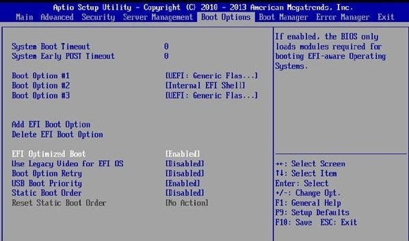

              Just FYI, I saw the exactly (!) same issue on the Intel S2600CP2, too. So, the predecessor board seems to share the same problem.
              Solution there is to enter the BIOS, go to "Boot Options" and set "EFI Optimized Boot" to "Enabled". By defaut this was disabled and caused the fade test problems.
                So yes, very likely a BIOS bug.
                Thanks for posting the solution.

                • johnthekayaker
                  • Sep 2008
                  I had this issue with the Intel S2600GZ. I found if I set the EFI Optimized Boot to Enabled in the Boot Options it runs without errors.
