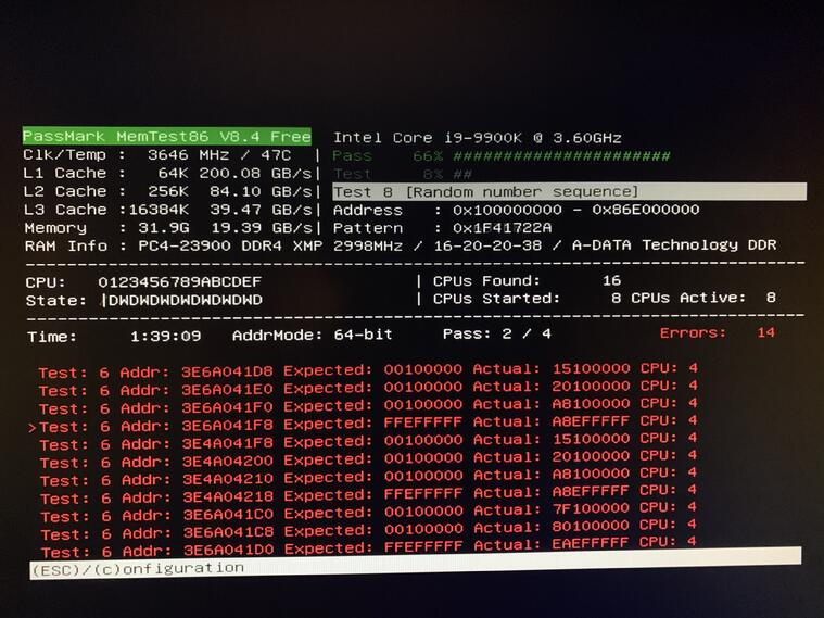

                        I’m not a super experienced person with computers. I started doing some research when my system would just suddenly turn off and reboot (not always successfully). My research lead to me doing a test with memtest86. I can’t give a full report like Damjam but I can say my BugcheckCode was 0 (meaning no error code was recorded). I’m wondering if my CPU has gone bad because of my overclocking (I keep my system cool, usually below 75c tops) any advice as to how I can further diagnose or fix would be appreciated. Also here’s a picture of my errors reported by memtest86
