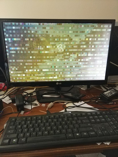

    The pc is now back from "repair" with following issues:
    Windows 10 installed:
    -Scrambled screen (small squares moving across the screen) - this reoccurs
    almost immediately after forced shutdown/turn on via button

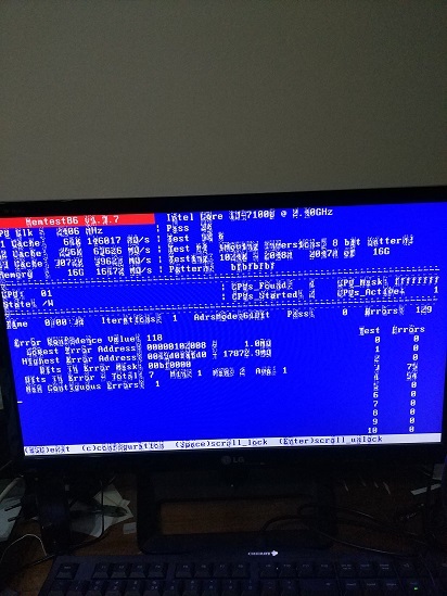

    This all sounded like memory problems, so I tried using memtest86. I saw that
    faults were listed but the problem is that after a while, the screen locks and a lot of
    columns / locations on the screen are jittering - so I have no clue how to identify the
    problem component.
    Would appreciate if someone would give me a pointer on how best to proceed.
    so I tried using memtest86. I saw that faults were listed
    If MemTest86 reports errors then the most likely conclusion is a RAM fault.
    Especially if you are also seeing random crashes in Windows.
    Hard to believe you sent it for repair and it was returned to you in this state. Either they don't care or they are incompetent.
    See this page for troubleshooting.

      Maybe it wasn't the best idea but I didn't send the memory + ssd with the pc. Attached are a few photos of what happens
      (the blue colored screen is the memtest86 jittering, the others in windows, besides that, the mentioned BSOD's occured).
      The mini-pc is attached to a monitor via hdmi cable.
      I tested the monitor and hdmi cable via a laptop - all is OK.
      So, what can I do to get to the bottom of this ?
