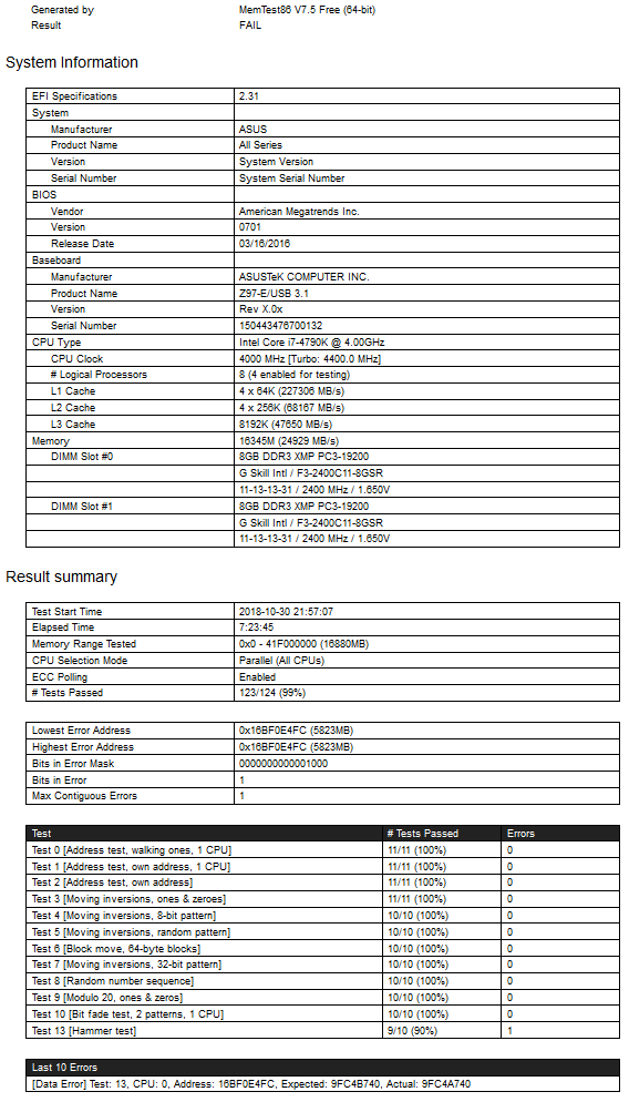

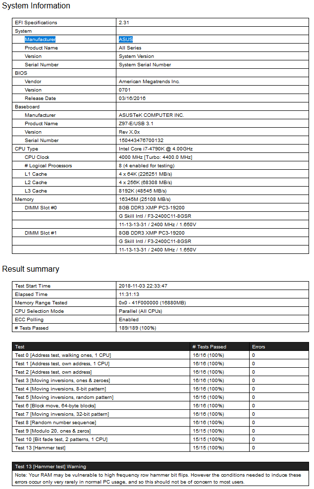

    7.5: Always the same single one bit error. 4.3.7: no error at all.

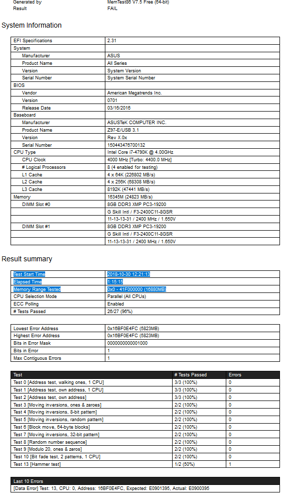

    I have run 3 different tests using memtest 7.5. During those tests memtest showed me the exact same result: one single bit error during the same hammer test at the same address. Also, only the first test seems to fail, all subsequent tests all seem to pass (on my third 7hours test, 9/10 tests passed)
    Also a 5 hours memtest 4.3.7 showed no error at all.
    Is my memkit defective?

    Errors in the hammer test are special. Not as serious as normal RAM errors. See this page for details.
    V4 of the software doesn't have a hammer test. So no surprise it didn't detect an error.

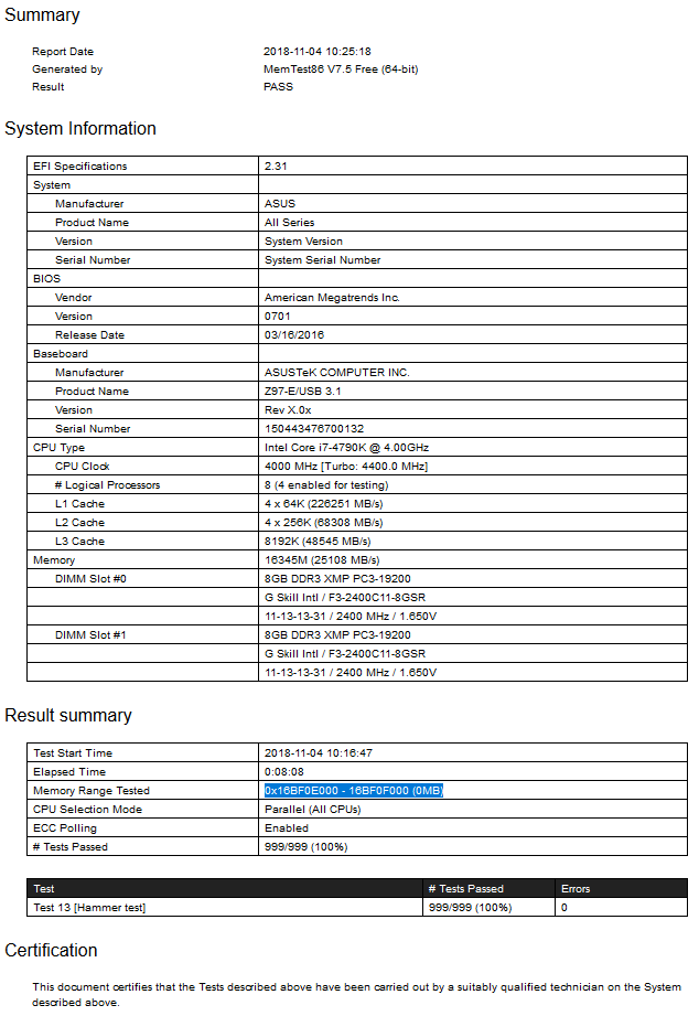

                I really don't understand what is happening. Because I was told by newegg support that if they didn't find any error on their end they would send me back my memkit, I decided to run another overnight memtest. It didn't find any error (test4.png). At all. Then I've run another test, selecting only the row hammer test, only testing the memory range impacted the first times. Same, no errors at all (memtest5.png).
                I did not do anything. Well I did reduce the DRAM Refresh Interval in the BIOS, I have then launched a memtest, which did not find any error so I put the DRAM Refresh Interval back to auto, which did go back to the value it was before I messed with it, and then launched the memtest pictured in test4.png, but I highly doubt it has anything to do with the memkit now passing the row hammer test.
                Please, do you have an opinion on the matter? Thank you.

                      In short I don't know and it is unlikely anyone else will know either. Row hammer errors are basically EMI events. So either the EMI environment was different. Or the memory cell really did improve it's performance, or it's performance is influenced by some external condition. e.g. temperature. None of which are going to be diagnosed remotely from a forum post.
