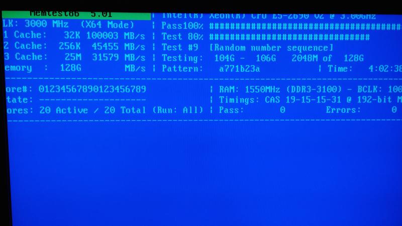

                c) rebooted, and as soon as memtest started, I hit 'F2'. Immediately, I was able to see that the program identified 20 cores (actually 10 cores, 2 threads-per-core). Things ran ok for the first 30 minutes, and then there was a burst of 48 errors. From memory, I think all of the errors were from a single processor, and the expect vs actual showed that almost no bits were correct in any of the errors. Finding this thread, I thought that the SMP mode was broken for my processor and

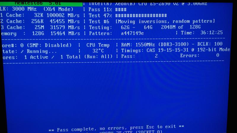

                d) I rebooted and ran again using default settings. Ran for 26+ hours and 2 complete passes with no errors. (strangely, the first pass completed in about 9 hours, whereas the second pass took longer). CPU temps were constant at between 29 and 33 degrees.See the attached screen shot showing the completed passes.
                e) today, I thought I'd try SMP mode again, but this time, I'm not seeing any errors - 4+ hours in. However, there's still some strangeness. It looked like the program got to the end of pass 1, where both the pass and test were at 100% for a long time (i.e. more than an hour) Now tests are progressing again, even though the pass progress is locked at 100%. The second screen shot shows the current state.
                  • 11115
                  bdon,
                  The screen shots you have posted are from MemTest86+. Which is not our software, even though they copied the name our of product, which makes it confusing.
                  I suggest you post to the MemTest86+ forum if you want help with their product.
                  Our product is the original and the best, MemTest86 (without the plus), which is currently at release V5.1
