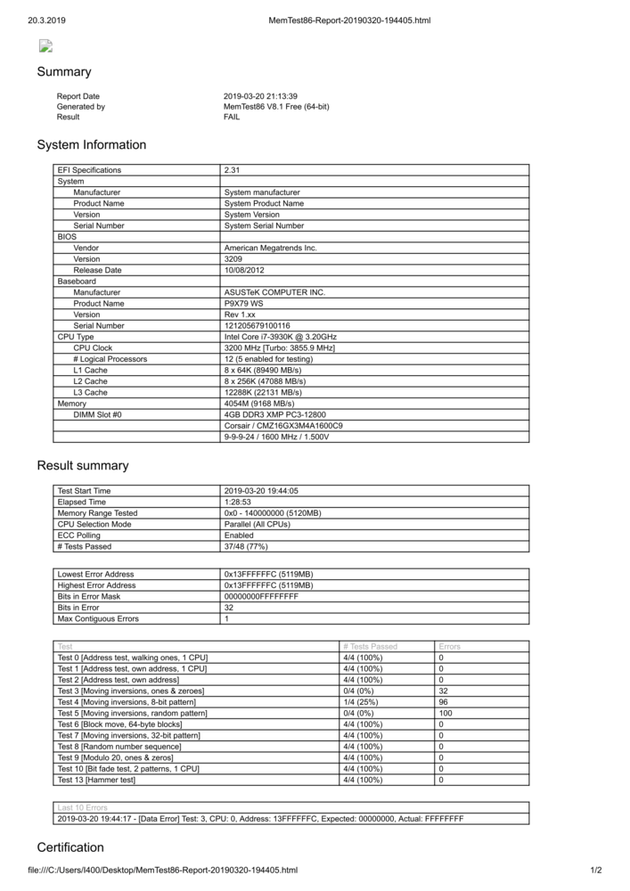

    Could anyone with brain look at these 4 logs and tell me what's up?
    (Could only upload 3, but you get the point, 4th log is the same)
    Was this machine ever stable?
    Did you install any new hardware components recently?
    Looks more like a BIOS bug where the BIOS is claiming a particular memory address (0x13FFFFFFC) is free to be used, but in fact it isn't free at all, but used by some other piece of hardware.

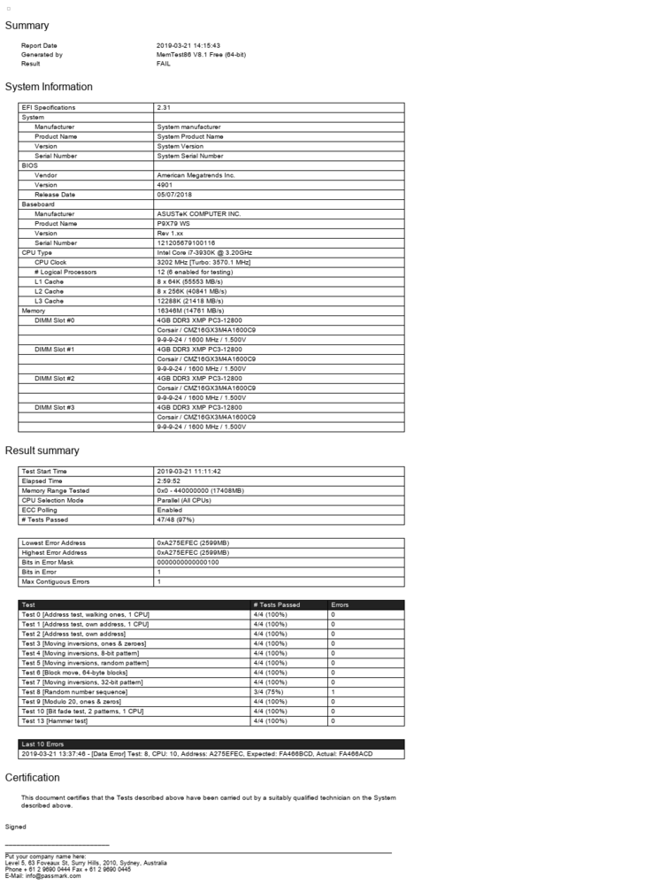

        I tested will all 4 sticks in at same time this time, and this is the result. I still wonder what the outcome means, any translation for us less gifted?
          So all that is a bit strange. As if there was a BIOS bug, it would have been in the machine and causing problems from day 1. Maybe it was a combination of changes (e.g. a Windows update, plus an old BIOS bug)
          After the BIOS update is the machine now stable (or more stable) in Windows?
          New test result looks a lot more like a bad RAM stick. There is just one byte with 1 bit in error, which almost always means bad RAM. Might be tempting to now go back to testing 1 stick at a time.
