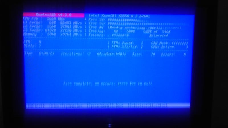

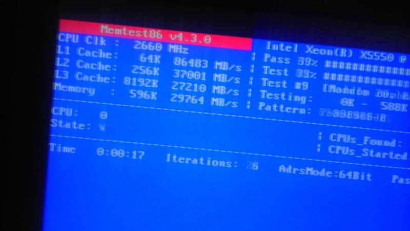

        OK, let's see whether I can figure out how to attach photos... lol
ID:	34822Click image for larger version
        OK, so here's a full screen and a close-up... again, system actually has 12GB of RAM... dual quad-core Xeon processors.
        -T-
          From the 2 photos it certainly looks like something is wrong.
          In V4.3 there is an option to dump out the memory map (under the configuration options). It would be good if you could tell us what is on that screen. Or even better send in a couple of photographs of that screen.
          Also, what BIOS version are you running, can you check for any available BIOS upgrades.
            There is also this HP document listing how the RAM should be installed.
            http://h20331.www2.hp.com/Hpsub/down...800_memory.pdf
            Seems there are a bunch of rules to follow regarding the distribution of RAM between the CPUs.
