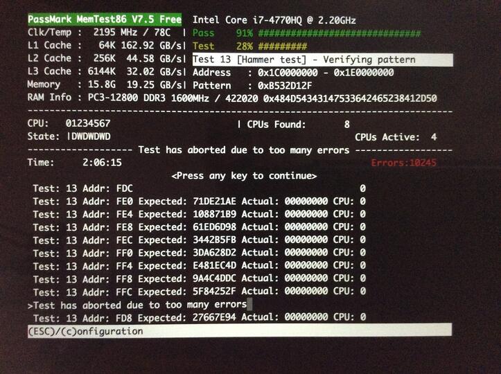

          Well, I'm not sure; my knowledge about these things is rudimentary. See attached photo of what was reported; I didn't keep any logs. I see all the errors that are shown were with Test #13?

            Yes, the addresses 0xFE0 to 0xFD8 are all below 0x10000. So it is surely the UEFI bug issue.
            (These are hexadecimal notation).
