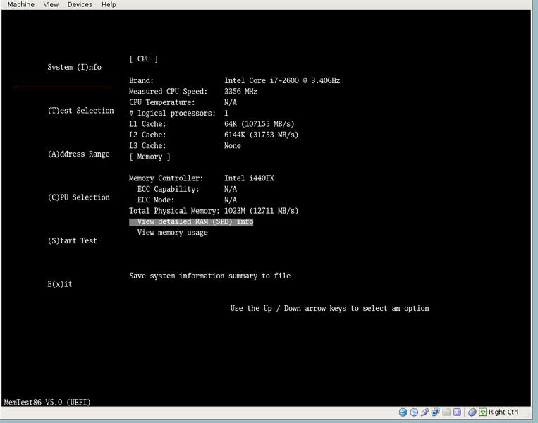

    Version 5 Screenshots
    Configuration screen
    Main test screen
    Optional report written to disk
    Detailed RAM SPD data
