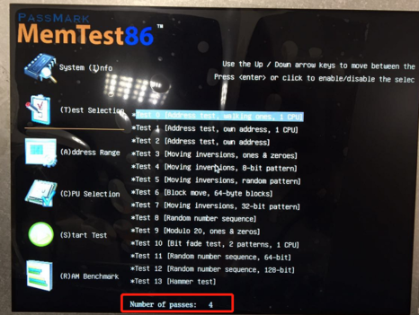

    The default memtest cycles is 4 times, But if I wanted to change it to 100 times, How do I set it? thanks
    I assume you are referring to the Pro release.
    You can selecting the number of passes from the menu, or you can set the number in the configuration file.

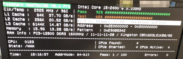

      Thank you for your reply. The version I tested was V8.1 pro.
      I have been inputting the number of passes from the menu, like setting 100.
      However, after 18 hours of testing, none of the cycles has been completed, so I am not sure whether the steps are correct or not.
        How much RAM is in the machine and what is the CPU type?
        Maybe you can post a screen shot / photo showing the screen a few hours into the testing.

          Please refer to the attachment for the pictures I tested
          By default£¨4 cycles), it only takes me about four hours to test a loop. If I set cycles to 100, the testing time becomes too long.

            If I choose 4, does it mean only Test 4[moving inversions, 8 bit pattern], or Test 0 ~ Test 13 should be executed 4 times in sequence
              If you select 4 for the number of passes, then it will do 4 passes (of the selected test(s)).
              But that first screen shot shows a CPU temperature of 96C, Which likely means the CPU will be thermally throttled.

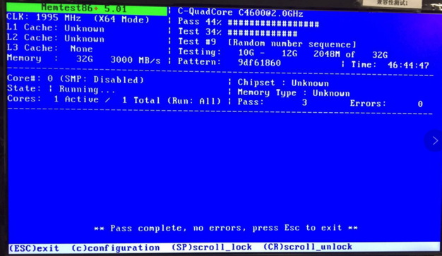

                In addition, I tested a group of DDR3L 1600MHz UDIM memory and found errors in both tests.
                First: [MEM ERROR - Data] Test: 11, CPU: 0, Address: 25D2466F8, Expected: 0C44B8761BE2D451, Actual: 0CC4B8761BE2D451
                SecondF[MEM ERROR - Data] Test: 11, CPU: 0,Address: 55ED6CA30, Expected: D45F53F9528DE8E0, Actual: D45F53F9538DE8E0

                But Memtest86+ tested three cycles and all the results were Pass
                What reasons do you think the passmark memtest failedHIs there a bad memory path that causes read and write errors? thanks
                  MemTest86+ V5.01 is pretty old now. It isn't even 64bit, but 64bit hardware has been available for nearly 20 years.
