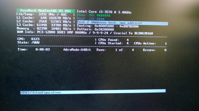

      When testing with 1 CPU core at a time running on memtest V5 it seems ok (though I have not left it for more than 20 min as it usually locks up by then.) It seems to lock up when set to sequential and so far on CPU 0.
      Interestingly no errors have shown on V5, it just locks up. When setting V4.3 to run with just 1 core it seems to run fine as well, with sequential displaying errors and resetting the computer. I have attached an image of V5 after the last crash. Could a CPU failure be specific to 1 core? does v4.3 and 5 always label the same cores as 0123?

        Yes, I think Core 0 should be the same core in both V4 and V5.
        If you are using v5 on a USB drive, there should be a log file that has been generated in the 'EFI/BOOT' directory called MemTest86.log. Could you EMail us this file.
        There is no log in V4.
        Yes, if it is a CPU failure, then it might be limited to a single Core.
