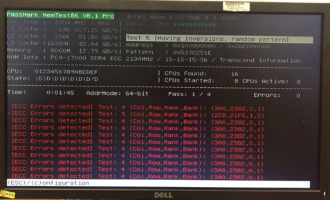

              The picture of my test is as follows. May I ask if my ECC test result is OK?
              Because this prompt error message has been corrected by ECC, the actual test result of memtest is still Pass

                In your screen shot the error count remained at zero. So there were no errors which could not be corrected.

                  Thank you. That would be great£¡
