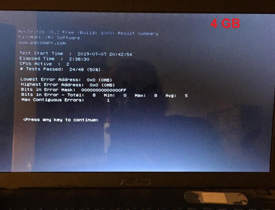

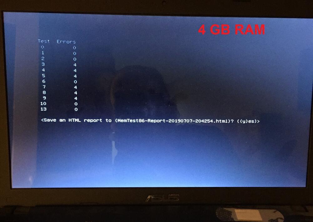

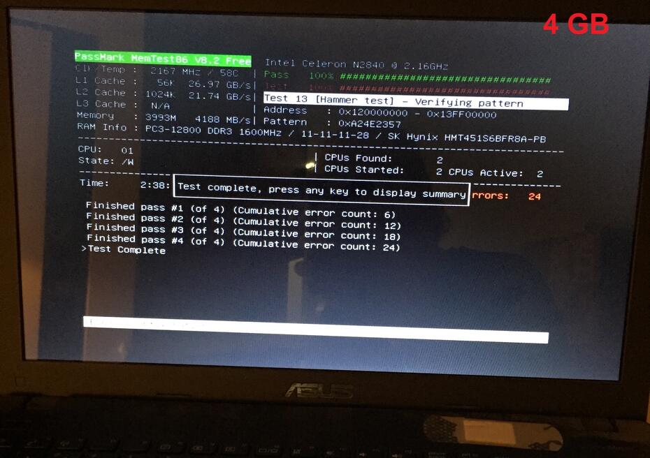

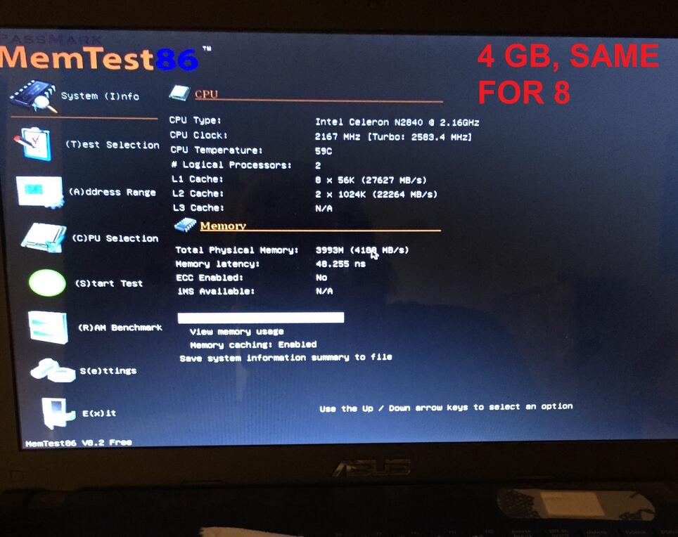

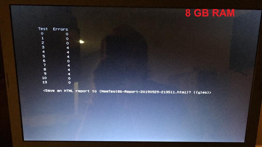

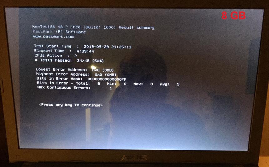

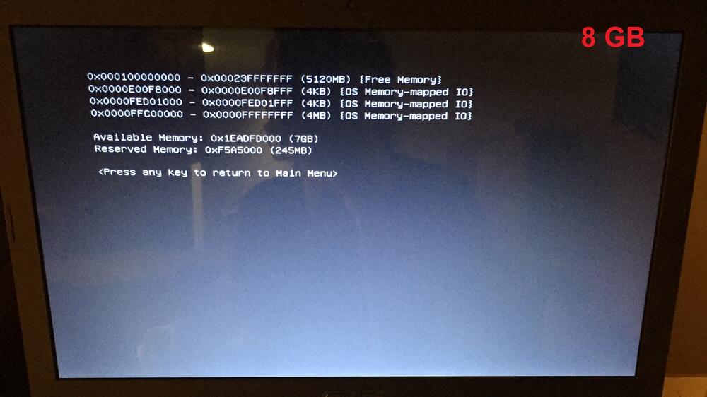

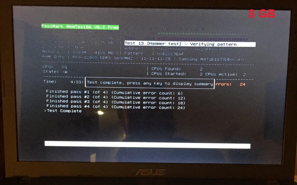

      I have some "screenshots" which may help. To summarize situation: PC came with 4GB RAM 1 stick, so before I upgraded it to 8GB 1 stick I ran both "Windows Memory Diagnostic" as well as "MemTest86" on the 4GB prior to removing it and then on the 8GB after installing it. Neither the 4GB nor the 8GB have ever given me any recognizable issues, so the RAM tests were just out of curiosity. Results were: Original 4GB had zero errors on WMD, but showed 6 errors on each pass of MT86, for a total of 24 errors on the 13 test 4 pass session. Lo and behold, the new 8GB had exactly the same results, ie zero errors on WMD, and 6 errors on each pass of MT86, for a total of 24 errors on the 4 passes. Too much of a coincidence to assume bad RAM??? Perhaps there is a clue in the test result screenshots?? WMD = 0 errors for both RAMs, 2 passes. Screenshots for MT86. Thanks. MAX 3 ATTACHMENTS PER POST, SEE NEXT 2 POSTS, AS THERE ARE 9 ATTACHMENTS.

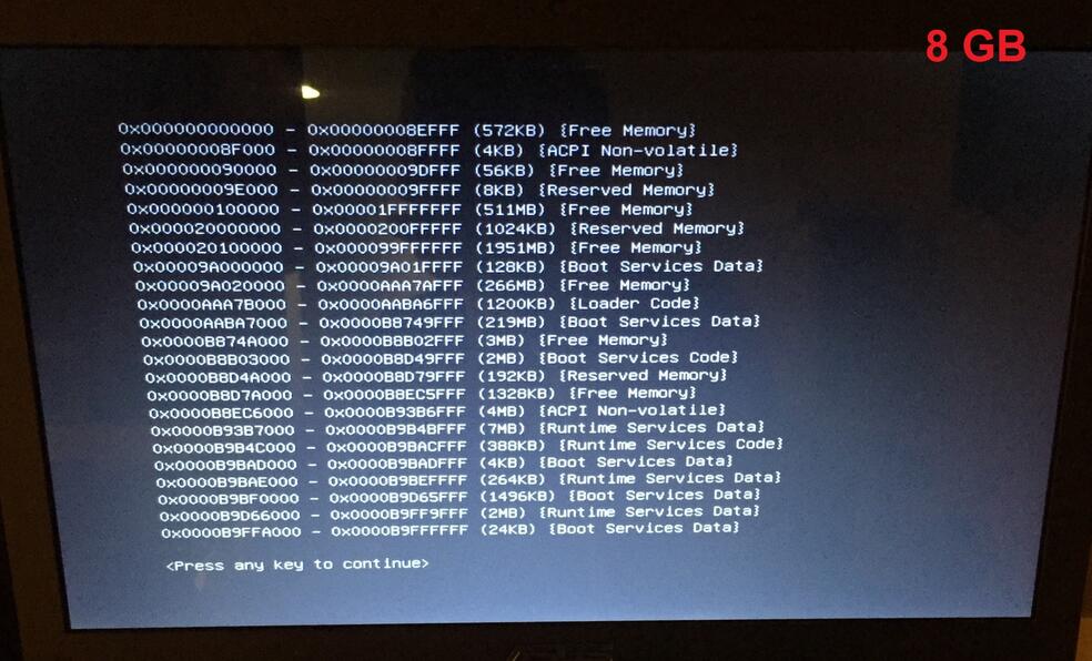

            Yes, it seems very likely it is a UEFI BIOS bug on this machine.
            Three points.
            1) The memory addresses in error were very low in the memory address range (all under 1MB)
            2) The BIOS memory map reports that the memory address range from address 0 to address 0x8EFFF is free and available for use. This is surely bollocks, as these low addresses ranges are nearly always in use by other hardware (see memory mapped I/O).
            3) There are lots of bits in error, 0xFF, which is 8 bits. Having single bit errors is more common when the RAM is at fault.
            Looks similar to the problem in bug in Apple's OS X 10.13 bootrom.
            https://www.passmark.com/forum/memte...apple-bootroms
            What is the make and model of the machine? (in case other people have the same problem)
