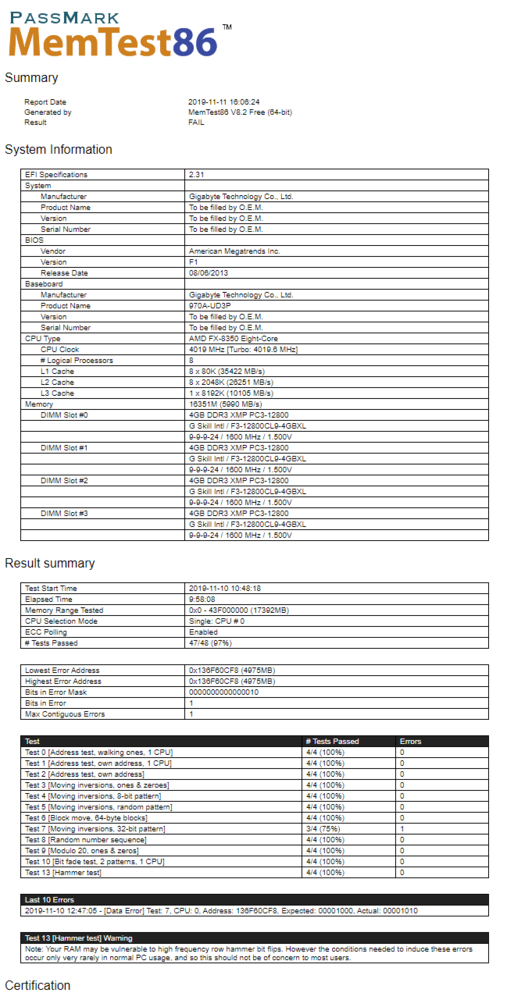

    Hi, I am hoping to get a little direction on some Memtest86 results.

    While seeking help on another forum I was directed to run Memtest86 and the results show a failure only on test 7.
    I ran the test with all ram installed, and it took quite a while so I didn't test each of the 4 sticks separately.
    Does 3/4 tests passed mean one of the 4 sticks didn't pass? Or not necessarily?
    I don't know if the memory is the cause of any of the crashing, but I am hoping it's something that simple.
    After looking at the attached results, can anyone advise me on the potential problem, or what steps I should take next?
    I appreciate any and all help. Thanks!

    3/4 Tests Passed, means 3 out of the 4 test runs passed.
    So the error isn't very reproducible.
    But one bad byte is enough to cause all kinds of random crashes, if you are unlucky.
    Maybe run with 8GB for a while and see how stable the machine is. The switch to the other 8GB.

      FYI, I started testing them separately, is that of any value ?
