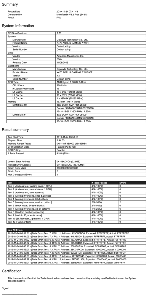

Memtest results - all errors are off by one digit
  • jt_weasley
    • Nov 2019
    I upgraded/rebuilt my system around a week ago and have been getting some BSODs for at least once a day since. [MEMORY_MANAGEMENT (most often), PFN_LIST_CORRUPT, SYSTEM_SERVICE_EXCEPTION]
    It's also worth mentioning that these seem to occur (only and so far) while gaming though I'm not sure if that's relevant or not.
    Memtest found errors in test 5,6,7 with all Errors off from Actuals by one digit (all in index #1 and #2).
    Is this the sign of faulty RAM or perhaps it's due to mainboard/BIOS faults?

          Hey, sorry I didn’t get a chance to reply.
          I spent all day yesterday troubleshooting in almost every way I could think of. Just when I’m about to give up I had the epiphany and it turns out the problem was right in front of me, literally.
          It was the XMP (Should have been first thing I tried tbh).
          I turned it off and manually set frequency, timings to its XM profile and the issue seemed to be fixed... I hoped.
          Memtest did not catch any errors and the machine hasn’t got any BSOD (so far, finger crossed).
          Unfortunately, I don’t have other compatible kits with me to test if it’s BIOS or hardware problems. I guess it’s probably both.
          Thank you again for your help and advice. Cheers.
