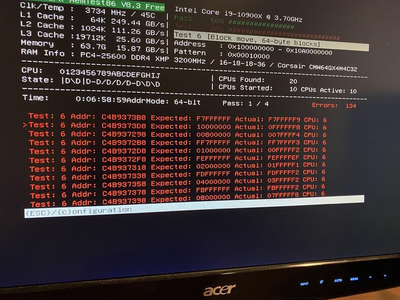

    Just finished my latest build last night and updated the drivers on the Gigabyte x299x Designare 10G mobo I'm using. I changed my BIOS setting to enable XMP to 3200 and kicked off the first test. I got about halfway through pass 1 and there were already around 50 errors. Don't have a screenshot of that, but the errors were exclusively on CPU 6. I got nervous that XMP was causing the errors so I exited that test, disabled XMP in BIOS and then restarted the test.
    This is a screenshot of the results so far on that next run. Noticing that in all runs every error has come from CPU 6. Also noticing that all but one of these errors are coming from the same address. Right now I'm planning on letting this run finish and then starting to troubleshoot by testing each RAM stick individually. Wanted to make sure that I'm going down the right path and that seeing the same CPU and address pop up continually wouldn't suggest something else.
    Thanks!

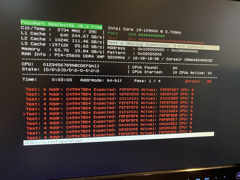

      based on that response I RMA the RAM and got new ones. Just started the test again and already on pass 1 I’ve gotten errors on tests 1, 2,3,4, and 5. They are still all coming from CPU 6.
      Including a screenshot from both the latest run that is running now as well as one from a previous run where it looks like some of the errors are way more than 1 bit. Based on this I think it’s highly unlikely that I got two bad sets of RAM.
      What should be my next step? BIOD issue, cpu issue, motherboard issue?

          All the error in your screen shots were very high in RAM (~53GB address range). If the addresses for the errors were a constant range, this might explain why you don't see it with less RAM (as you don't reach the 53GB level).
          And you are right, if you are now getting errors with lots of bits being flipped, it does make it less likely that the RAM is at fault.
          I wonder how well Gigabyte tested this motherboard with 64GB of RAM.
          If you had a spare CPU sitting around, I would swap the CPU next. But you probably don't have a spare.
          Is the BIOS up to date? It might be a memory map issue in the BIOS. (Mapping the same memory address range to two things)
