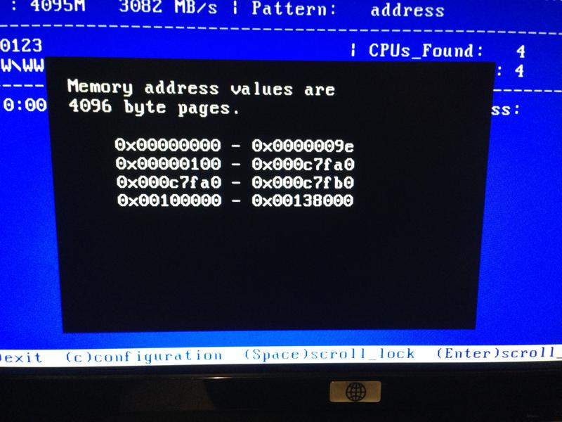

        Thanks for the video. I don't see any obvious reasons why it would freeze at that particular trace point. Can you take a screenshot of the memory map by pressing 'c' -> Miscellaneous Options -> Print Memory Map. Also, make sure you have the latest BIOS for your motherboard.
          Here you go. Thanks for looking at all of this.

            Thanks, there doesn't seem to be anything strange about the memory map.
