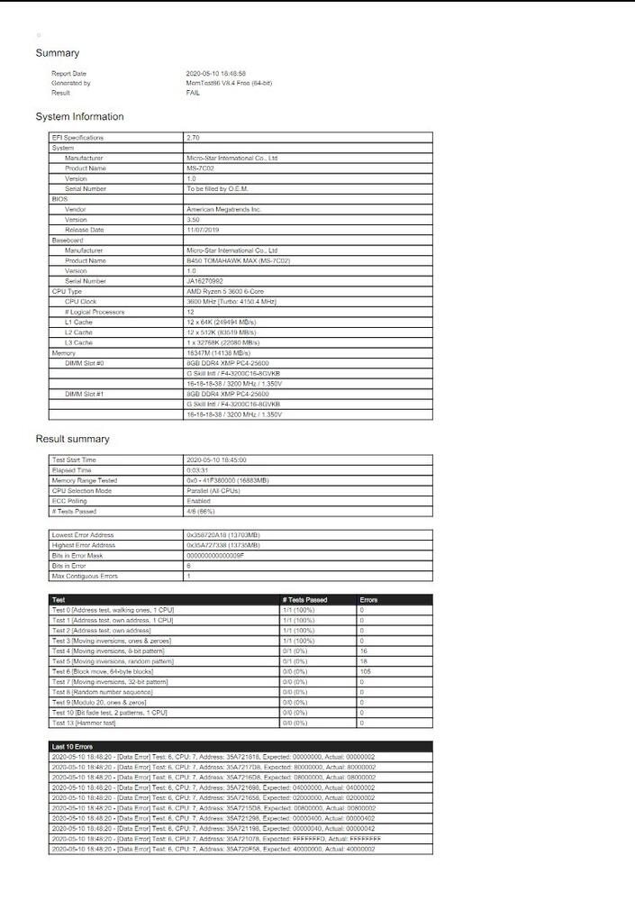

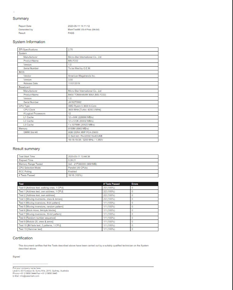

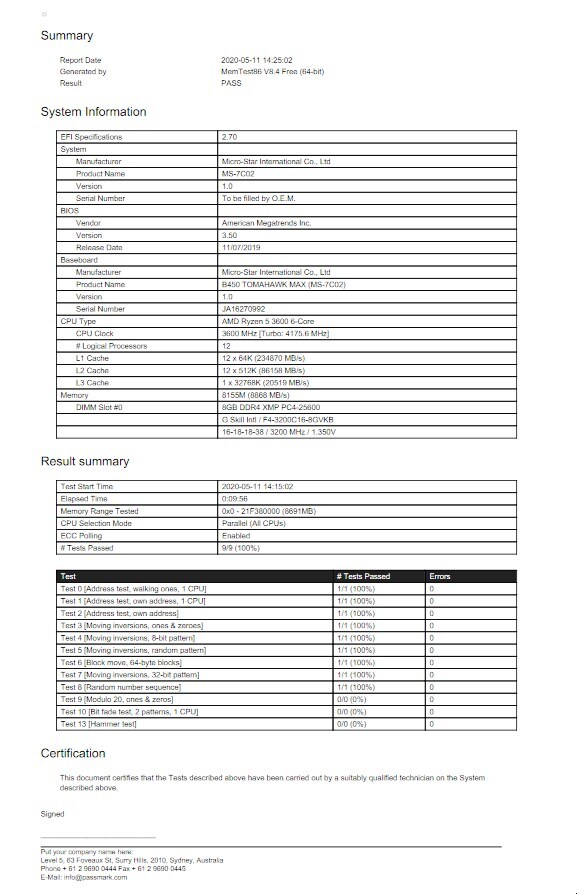

    I tested each of my 2 sticks individually and only 1 slot shows no error while the other 3 report errors starting from test 4.
    Obviously that means if I want to run both my sticks I will get errors as well.
    Is the correct conclusion that my motherboard has 3 bad slots or is there still a possibility of my ram being bad or perhaps some bios error?
