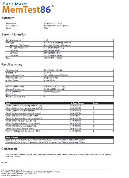

    Was hoping someone would be able to decipher this better than I can.
    13inch Macbook Pro - If any other information is required, ask.

    Reran the tests with different RAM modules - no errors. Placed the same RAM modules back in - no errors.
    I can't determine what's failing, if it fails intermittently. This makes it impossible to do process of elimination being that I can not successfully replicate or produce the errors.

      Looks like the RAM might be bad. But only a couple of bits were wrong in 3 hours of testing. So it isn't a very dramatic failure.
      Is the machine stable in normal use?
        Machine is stable during use and only intermittently fails to POST - giving off three audible beeps in recession indicating RAM failure.
        To fix the issue of it failing to POST, the RAM is reseated. This is a temporary fix, however, until the next time it fails to POST.
