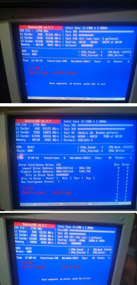

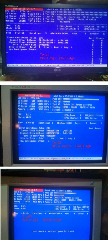

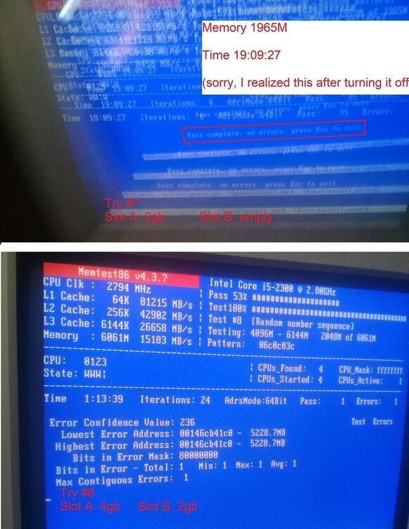

    These are my results. I'll call the slots in the mobo "A" and "B". "X" means empty slot.
    *try 1-> A: 2 - B: 4 - failed (8,5hrs)
    *try 2-> A: X - B: 4 - failed (8hrs)
    *try 3-> A: 2 - B: X - pass (4hrs)
    *try 4-> A: 4 - B: X - pass (13hrs)
    *try 5-> A: X - B: 4 - failed (10hrs, 1st error 5hrs)
    *try 6-> A: X - B: 2 - pass (17hrs)
    *try 7-> A: 2 - B: X - pass (19hrs)
    *try 8-> A: 4 - B: 2 - failed (1hr)
    So... I was ready to conclude that the 4gb stick is failing but it was ok for 11 passes (13 hours). But if failed in one slot and not in the other.

    I attach images with the tests for reference.
    Regards!

      I can't edit my post and I see my attachments are low quality now, so here they are in hq:
      Tries 1, 2 and 3
      Tries 4, 5 and 6
      Tries 7 and 8
      Regards
