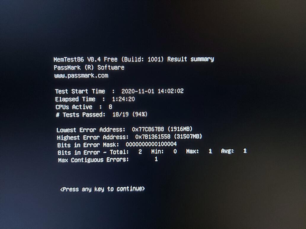

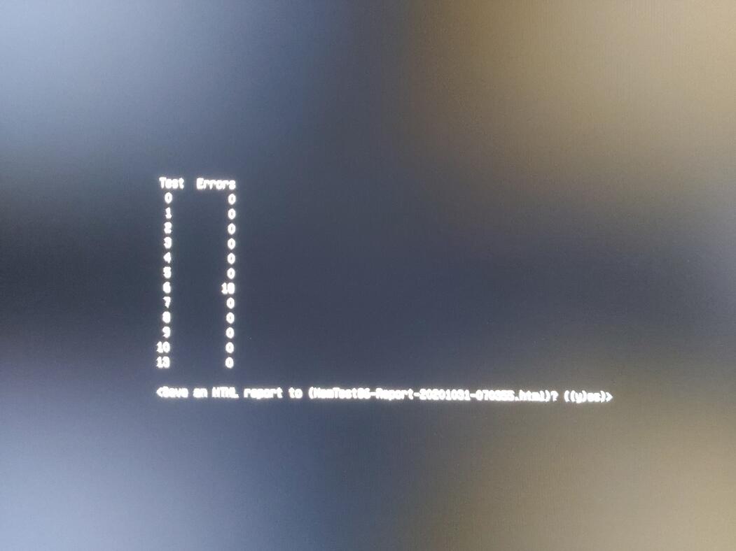

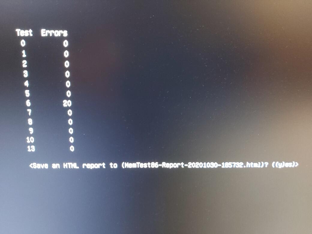

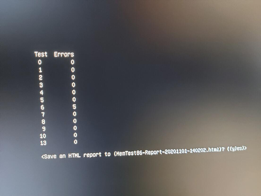

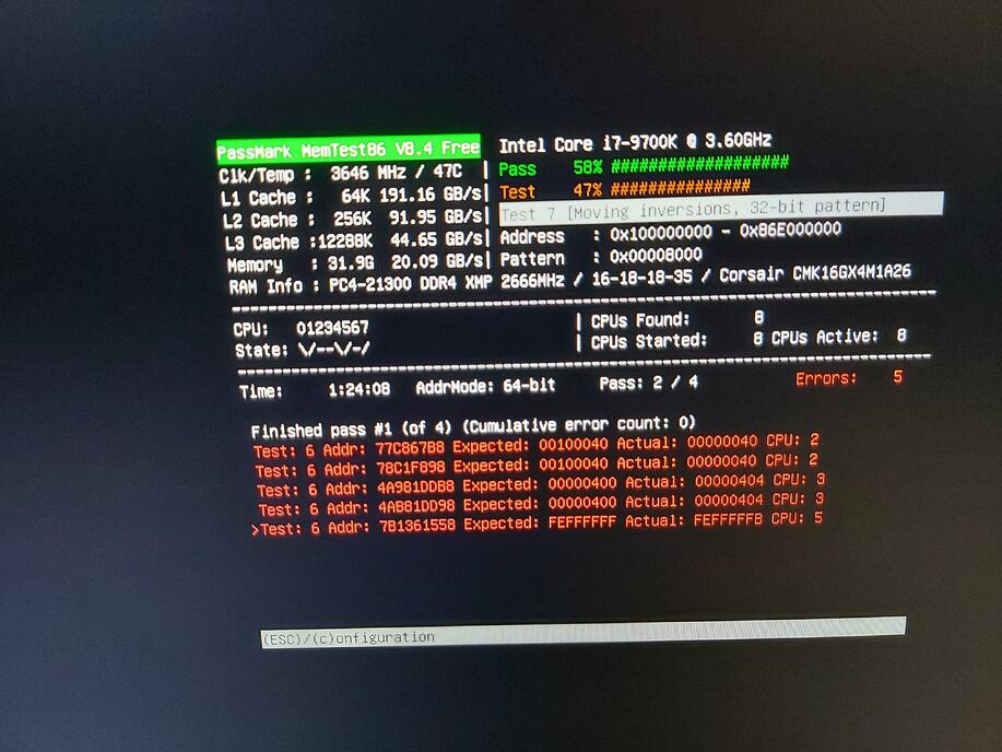

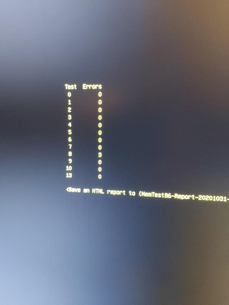

    I have tested the ram with memtest and got the below results.
    stick 1 slot b1 - no errors
    Stick 2 slot b1 - no errors
    Stick 1 slot b2 - errors on test 6
    stick 2 slot b2 - errors on test 8
    Bot sticks slot b1 and b2 - errors on test 6
    I have uploaded pictures of results.

    Would have been nice to see the actual errors and not just the error count.
    Unlikely the problem is due to the PSU. Maybe both slot and RAM are marginal.
    The Msi z390 pro carbon has 4 RAM slots, can you try running the machine off the currently unused slots (A1 & B1). The manual might have said to use A2 & B2 first, but it should still work. (A1 & A2 will probably also work, but in single channel mode).

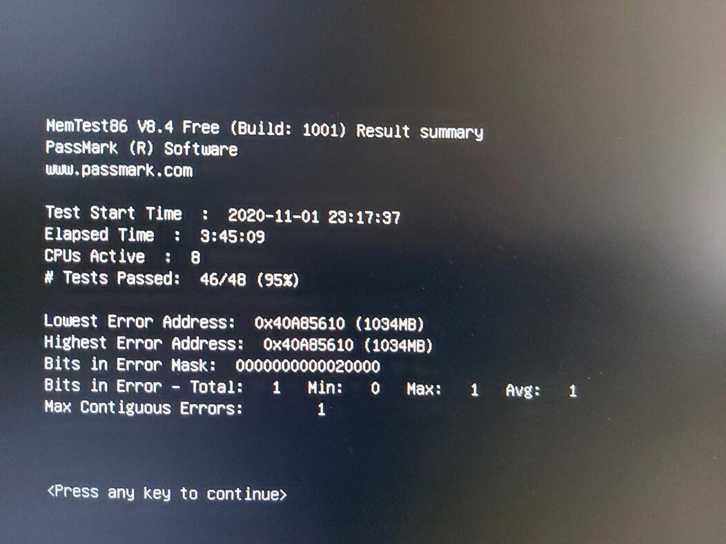

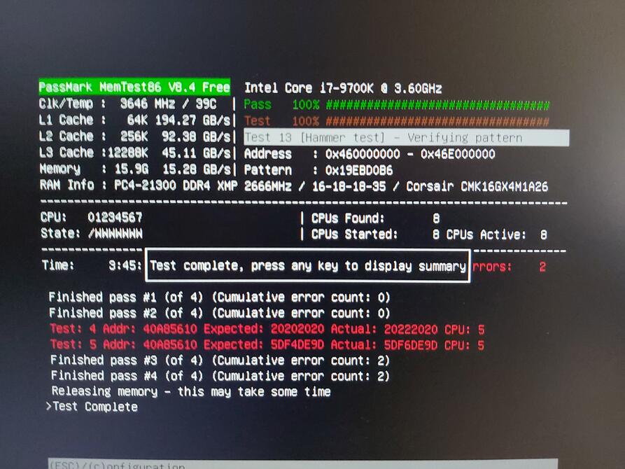

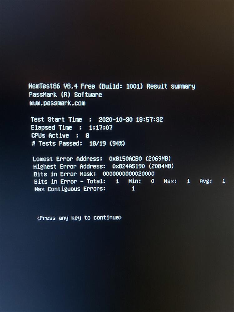

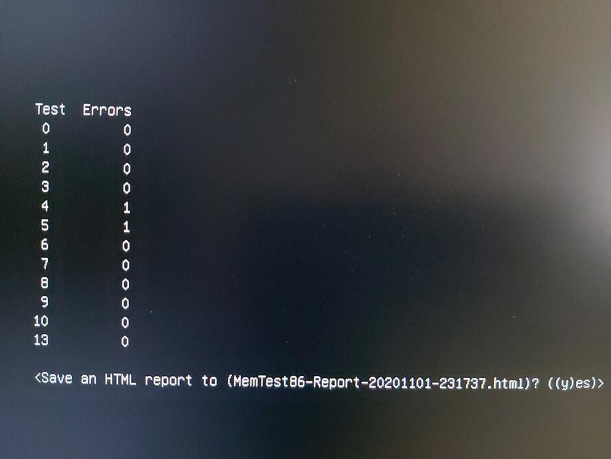

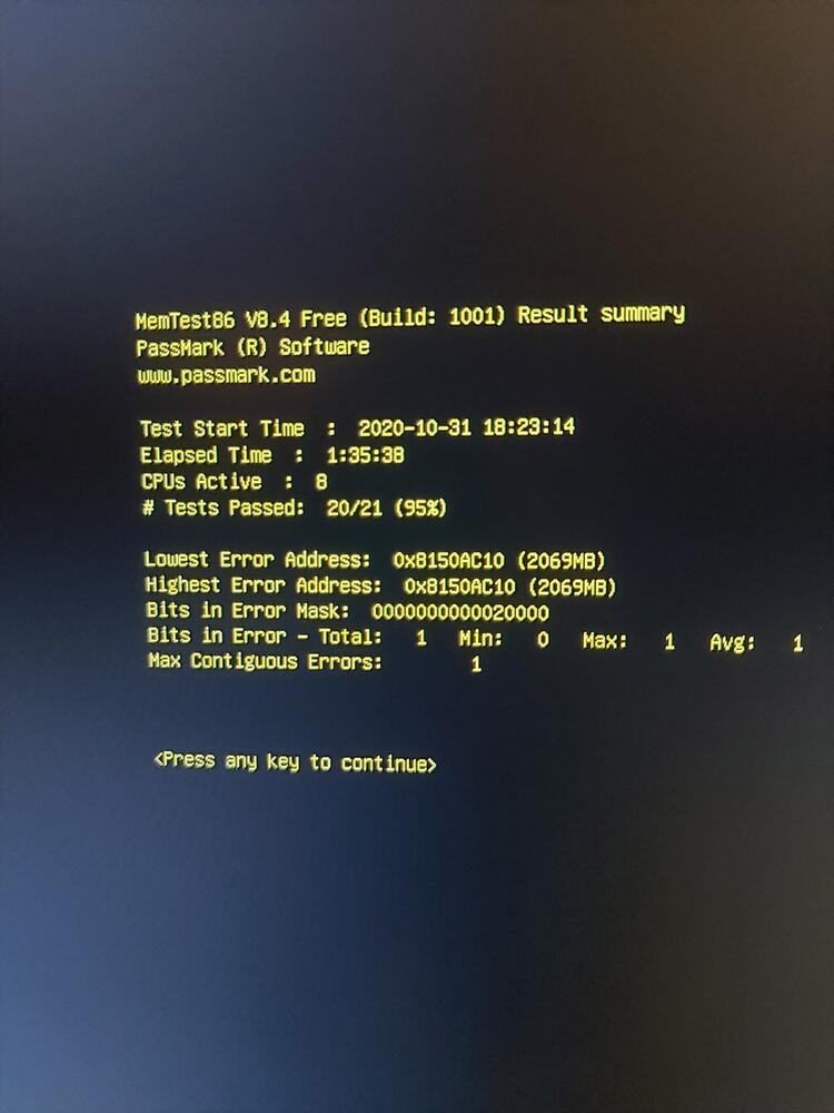

                  It is unclear which screen shots were from which RAM sticks in which slots.
                  But maybe it doesn't matter. It looks like a single bit in error in a small range of addresses. So this does in fact look like a real RAM failure.
                  If it doesn't happen all the time then it might be just marginal (right on the edge of failure). And slightly higher voltages or slightly different timing in different slots gets it working more reliably.
                  Under clocking the RAM in BIOS might get it to be more stable. Otherwise I would be tempted to replace it.

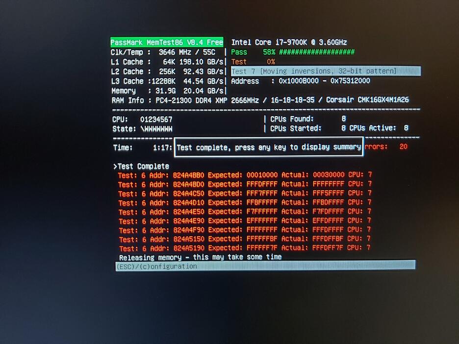

                      Stick 1 on slot A2 - 2 errors
                      Below are the errors i got
