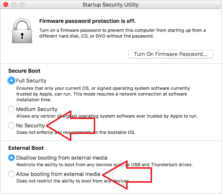

                On a Mac, you need to hold down the ALT / Option key on the Mac keyboard while powering on the machine to boot from USB.
                On newer Macs, from around 2019(*), with the Apple T2 Security Chip, you may need to change the SecureBoot settings for MemTest86 to boot. Please see the following page for instructions:
                https://support.apple.com/en-us/HT208330
                (*) These Mac computers have the Apple T2 Security Chip:
                Allow booting from external drives and allow booting from non-apple software,

                      On newer Macs, from around 2019​ with the Apple T2 Security Chip, you may need to change the SecureBoot settings for MemTest86 to boot. Please see the screen shot in post above & following page for instructions:
