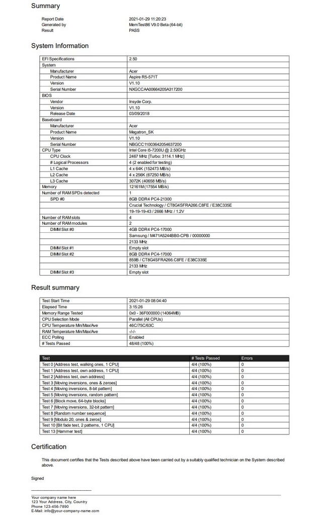

    MemTest86 v9.0 Beta 2 Release (2021-01-20): Log file (small: 41KB) is attached.
    MemTest86 v9.0 Beta 1 Release (2020-12-03): Could not attach Log (too large: 160 KB) nor Report (HTML not permitted).

              I converted the MemTest86 v9.0 Beta 1 HTML Report into a jpg.
              Please find it attached.

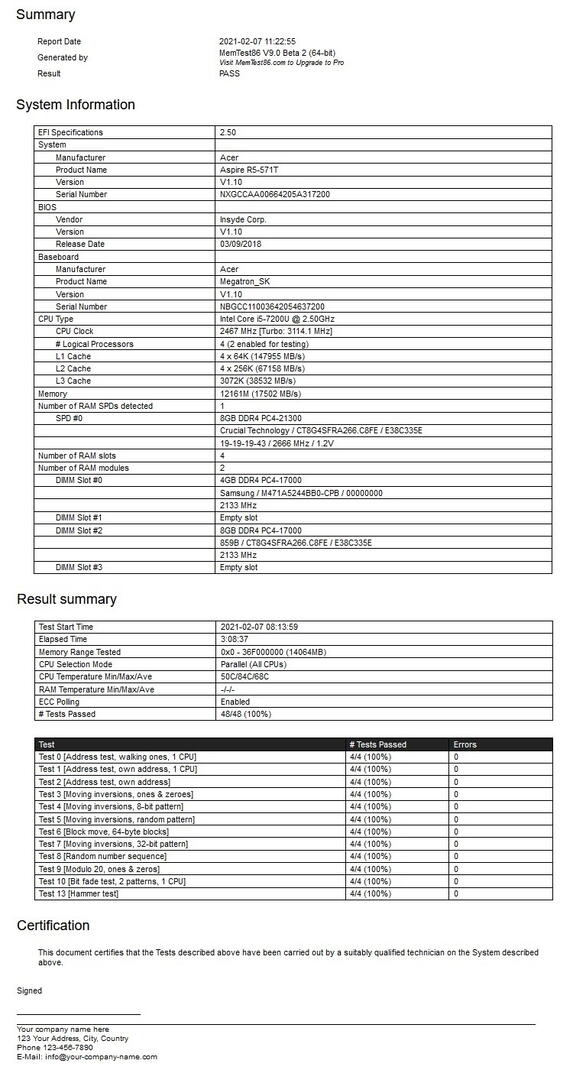

                          Well, it took me a few days (02-03-2021 to 02-07-2021) ... but I finally got PassMark MemTest86 v9.0 Beta 2-0007 to run.
                          Using a combination of:
                          Linux PreLoader (PreLoader.efi & HashTool.efi), Easy2Boot agFm File Manager (grubfmx64.efi),
                          and signing the PassMark MemTest86 v9.0 Beta 2-0007 Boot file (BOOTX64.efi),
                          I managed to add a MOK/hash to my machine and subsequently run it.
                          Log files attached (a set of three (3)), followed by the MemTest86 v9.0 Beta 2-0007 HTML Report (converted into a jpg).
                          All tests ran without issue.
                          (I thought there was supposed to be an audible alert at test completion (I was present for the test completion),
                          but there wasn't ... just the PASS dialog box ...

                            I converted the MemTest86 v9.0 Beta 2-0007 HTML Report into a jpg.

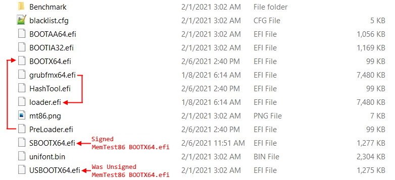

                              I was archiving (and attempting to document) the configuration I created
                              to make PassMark MemTest86 v9.0 Beta 2-0007 work for me,
                              and discovered a small error on my part ...
                              (Ex-co-worker jpe (jokingly): I can't believe it! You made a mistake?!?!?
                              In my haste, while trying to rename files to test my latest idea, I accidentally renamed
                              PassMark MemTest86 v9.0 Beta 2-0007 BOOTX64.efi as USBOOTX64efi (US for UnSigned) ...
                              Apparently, Easy2Boot agFM File Manager does not recognize a .efi file as a .efi file
                              unless it specifically has a .efi extension name. I corrected the file extension name, and re-tested ...
                              Easy2Boot agFM File Manager was able to recognize and run
                              the unsigned PassMark MemTest86 v9.0 Beta 2-0007 Boot .efi file
                              without needing to add its MOK/Hash.
                              So (apparently) there was no need to sign the PassMark MemTest86 v9.0 Beta 2-0007 Boot file after all.
                              Might be handy to know if/when another Boot file needs to be tested when using Secure Boot ...
                              Attached is a list of files I used (in directory EFI/BOOT):
Name:	PassMark MemTest86 v9.0-Beta-2-0007 Layout.jpg
