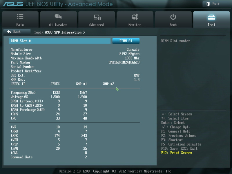

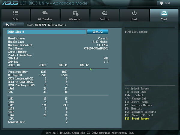

      hardware information :
ID:	49832Click image for larger version
ID:	49833Click image for larger version

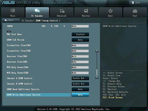

        hardware information 2 :
ID:	49836Click image for larger version

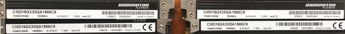

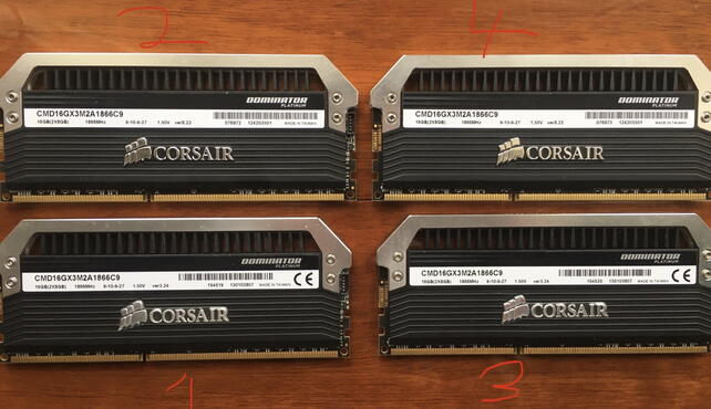

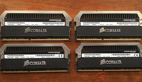

        above you'll see the lay out they were put in to the dram slots, if 2 was put in 1, and 1 was put in 2 so on so on, i would end up with errors,
        the version 3.24 sticks had to go in slot (A1) and (B1) where as the version 8.22 had to go in slot (A2) and (B2) putting the worst foot 1st then the best foot last
        as you can see from the slot read outs, the sticks are not the same, yet looking at them, they are the same, this was one of the hardest problems ive worked on, as you wouldn't know just by looking really

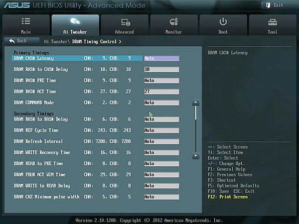

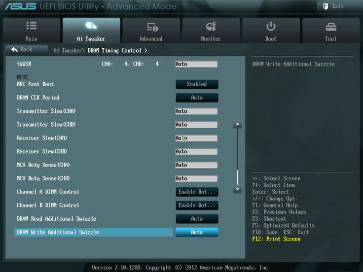

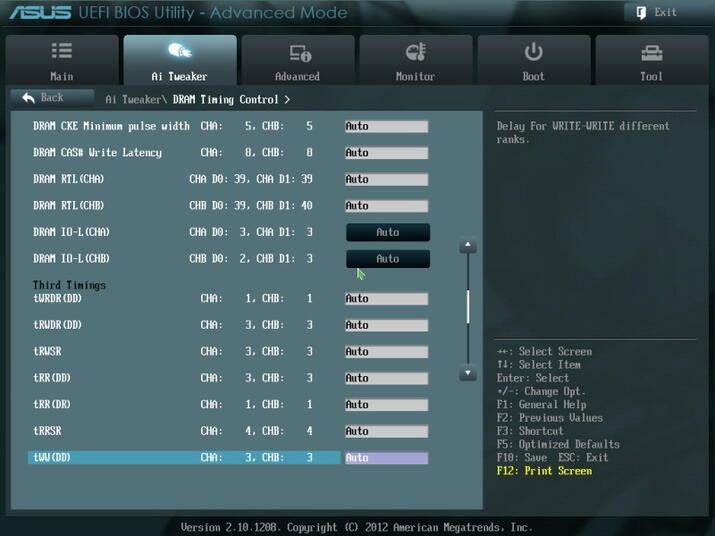

          Xmp off, manual
ID:	49839Click image for larger version
ID:	49840Click image for larger version
          if i go manual i end up with errors and i dont know why ? 1866mz

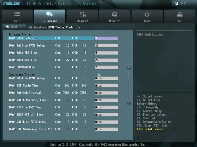

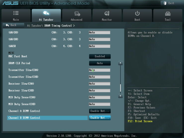

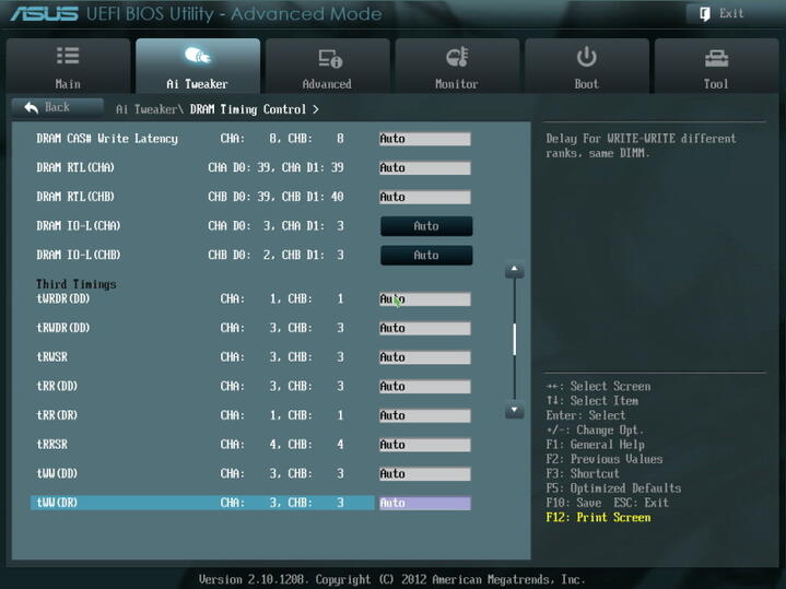

            this is with xmp on, this gets me no errors, i also override xmp voltage to 1.4600v
ID:	49843Click image for larger version
ID:	49844Click image for larger version
            again all images have been resized, taking up hardly anything, so please dont delete the images
            i would like someone to help me work out what xmp is setting to make this ram work ? cause i cant see what its changing, it doesn't seem to be listing it in the bios ?

              zoomed in view of what is says on the ram its self

                  David (PassMark) you won’t believe this! It was the order of the dims in the slots, all 4 dims have sticks, but if I swapped version 3.24 sticks with places the version 8.22 sticks were in, I would get errors, no joke. The ver 3.24 sticks had to go in the 1st row that go to the cpu (A1 and B1) and ver 8.22 had to go in (A2 and B2) I can’t believe swapping which go where would be such an issue? they are all working at the same timing and voltage, I can manually input the settings again with out xmp. what the developer is going on!

                        I switched them back to how they were before and the problem came back, order definitely matters
                        this is definitely a thing, I’ve moved them back and forward and having the lower version number 1st and the higher number last in each zone (A1-ver3.24) (A2-ver8.22) (B1-ver3.24) (B2-ver8.22) definitely solve the issue.
