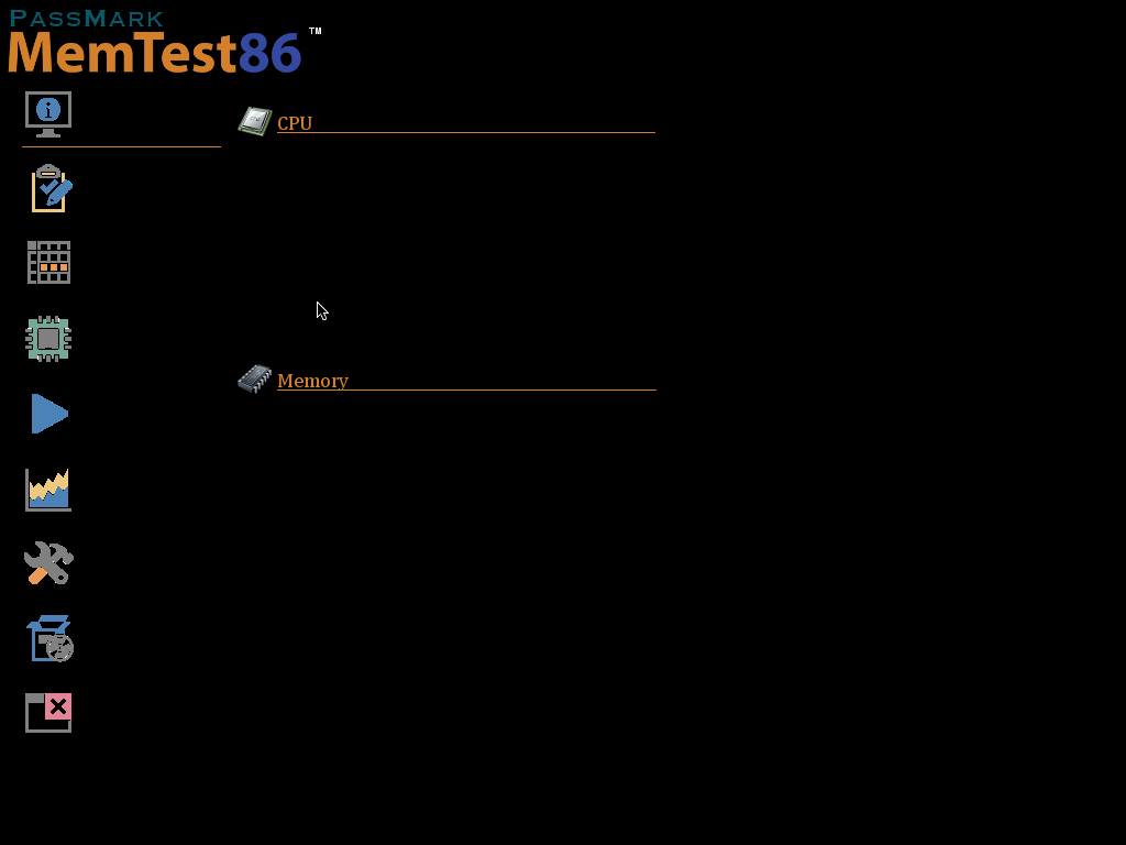

    When I boot this new 9.0 release from USB on my Thinkpad T550, it acts as if there are no fonts found. I'm attaching a screenshot of that.

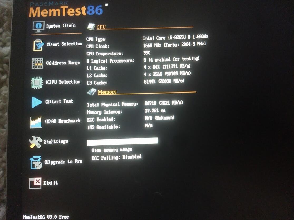

    When I boot on my ProBook 450 G6, I can actually see text but the icons are still the "ugly" ones you see in the T550's screenshot. Looks nothing like 9.0-beta2 did.
    I was first copying the image to my usb stick via dd in linux, but now I have also tried using your ImageUSB tool from Win10, and it still has the same problem.
    Is this a problem on my end or is there a problem with this release?

    And here is what it looks like on the ProBook

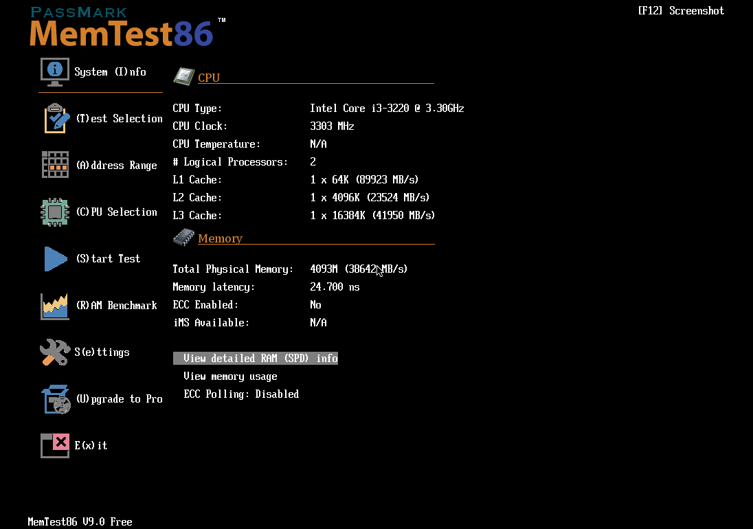

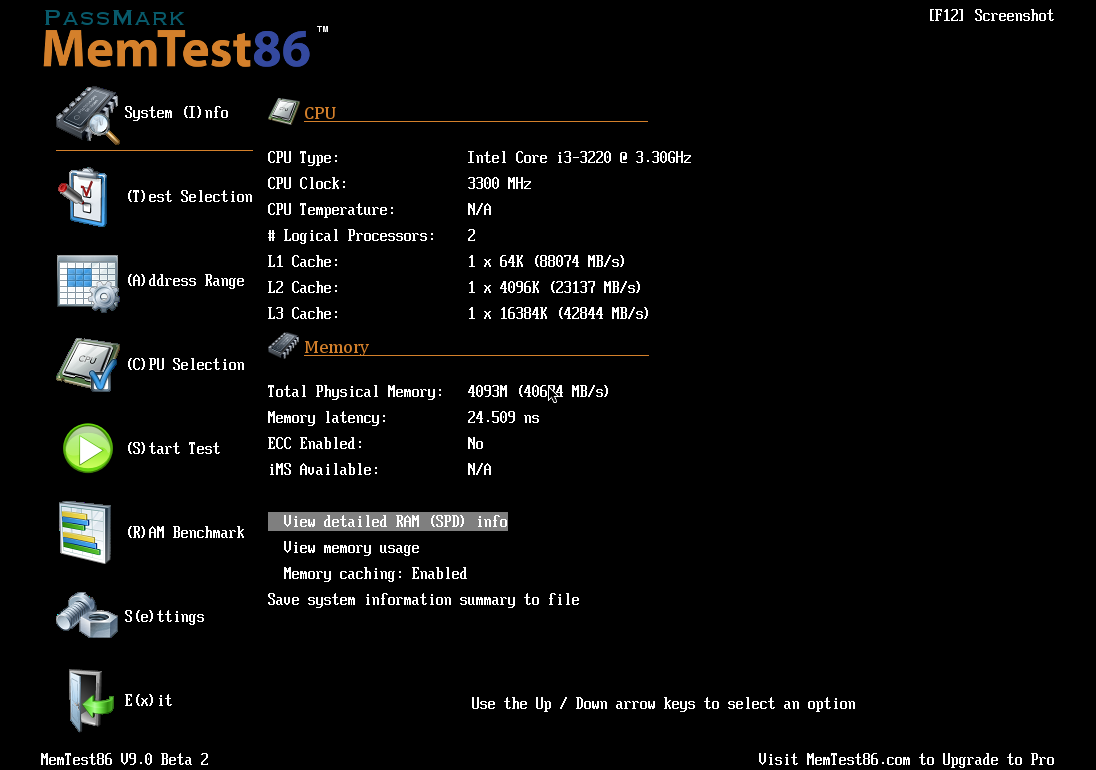

      I booted 9.0_beta2 and 9.0 in qemu and you can see the difference. They do both have working fonts/text though.

              This does indeed fix text on my thinkpad! The rest of the graphics are still pretty ugly though, like they are using 16 colors instead of 256 or whatever the previous version had. Is that an expected change?
              That part, I'm able to reproduce everywhere-- thinkpad, probook, qemu.
                Originally posted by bkohler
                This does indeed fix text on my thinkpad! The rest of the graphics are still pretty ugly though, like they are using 16 colors instead of 256 or whatever the previous version had. Is that an expected change?.
                Yes, thanks for pointing it out.
                There was an issue with handling the transparency channel of the images. This should be fixed by the next release.

                  This new build 2000 does have working text on my thinkpad, but still the icons are ugly everywhere I test... tested on thinkpad, thinkcentre, and in qemu.
                  Should I open a new thread?
                    Can you post an image / photo, maybe ugly is normal.
                    • bkohler
                      • Apr 2020
                      • 11
                      My previous comment #3 shows the good vs ugly, is anyone still getting the "good" icons anymore?
                      I got them back in beta2
                        They look like Post #8 above for us. And this is how they are meant to look in the final release.
                        • bkohler
                          • Apr 2020
                          • 11
                          Ok thanks, it just surprised me that it changed so drastically between a beta and the final release. Looks like all is well.
