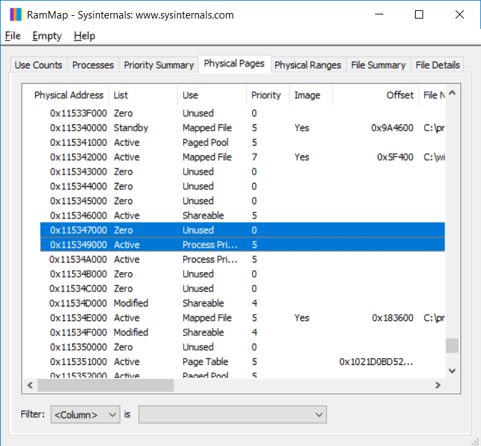

                I know this is an old thread, but since there is very little information on this topic I would like to share my experience:
                I have an ASUS UX31A Ultrabook (Core i5-3317U, 4GB Onboard Memory DDR3 1600) that had been bluescreening with various error messages about once a week during moderately heave office use. MemTest86 as well as MemTest86+ found one single Bit Error:
                ==> Addr: 11348860 Expected BFBFBF Actual: BFBF3FBF
                This Address was always the same one (and the problem was neither getting worse or resolving over many months). It was very hard to reproduce the memory error in other - Windows based memory tests so initially I was not even sure if it was real. Guess I should not have doubted memtest86! Since reinstallations of the OS did not fix the problems and the roughly weekly bluescreens persisted I continued investigating.
                I was finally able to reproduce the error in Prime95 (x64) using Torture Test #3 "Blend" with "Memory to use" increased to ~3000-3200 or so.
                Seeing the error here took about 3-4 hours for 2 of the 4 prime tasks to abort with "Hardware failure detected" while 2 tasks continued running without error for >10 hours! So it was really hard to prove the problem.
                Unfortunately, the memory is soldered on the motherboard so there was no way to replace it! But this thread really rescued the Laptop!
                Hex-Dividing the Adress 0x11348860 by 0x1000 resulted in 0x115348 so I then ran:
                Code:
                bcdedit /set badmemorylist 0x115348
                bcdedit /set badmemoryaccess no
                And rebooted. With the sysinternals RamMap tool I observed the following:
                - under Use Counts, the "Total" Memory decreased from 4.077.488K to 4.077.484K => yay
                - under Phyisical Pages / Physicial Adress there was a 0x115348000 before, and after the changes this line was gone - 0x115347000 now directly followed by 0x115349000 !
                I then started Prime95 again and let it run with identical settings as before for more than 27 hours and NO MORE ERRORS!
                So basically this laptop is now almost fully fixed. As long as you stay in Windows and Windows is properly configured. If you start a boot CD (for example to restore a disk image backup) there is a slight chance that the flipping bit will cause you a problem, but since it's a pretty high adress I hope that even this would be a rare event and not too tragic.
