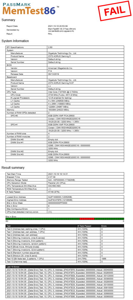

    Hi, I have a problem of random coded Bsod so I decided to run memtest to check my rams. This random coded Bsods happened like 1 year ago and I found out my previous rams corrupted by again using memtest (even Windows' own memory tool gave error back then).
    Most of the time before the Bsod the game I am playing or the current tab opened in firefox crashes then in short period of time Bsod with random code happens.
    So with this new set of ram I ran memtest 2 times. In the first run memtest did not find any error but in the second run it found 1956 errors in Test 10. Intel says this -> https://www.intel.com/content/www/us...-products.html .
    So does this means this set of rams also gone or not? I have the .html report saved if it needed. Also I am using Corsair / CMK16GX4M2E3200C16 rams and Gigabyte Z370 AORUS Gaming 5 and using Bios F14 https://www.gigabyte.com/Motherboard...upport-dl-bios .
    Thanks.

      Since .html files are not allowed I am uploading the screenshot of it. Cannot upload log file right now because it exceeds the limit. Can provide link to it if it s needed. Also just got another Bsod with Memory Management code just now.

              Definitely looks like a hardware problem of some sort. Do you have any overclocking/XMP applied to the memory? If so, try disabling with both sticks installed and run memtest.
