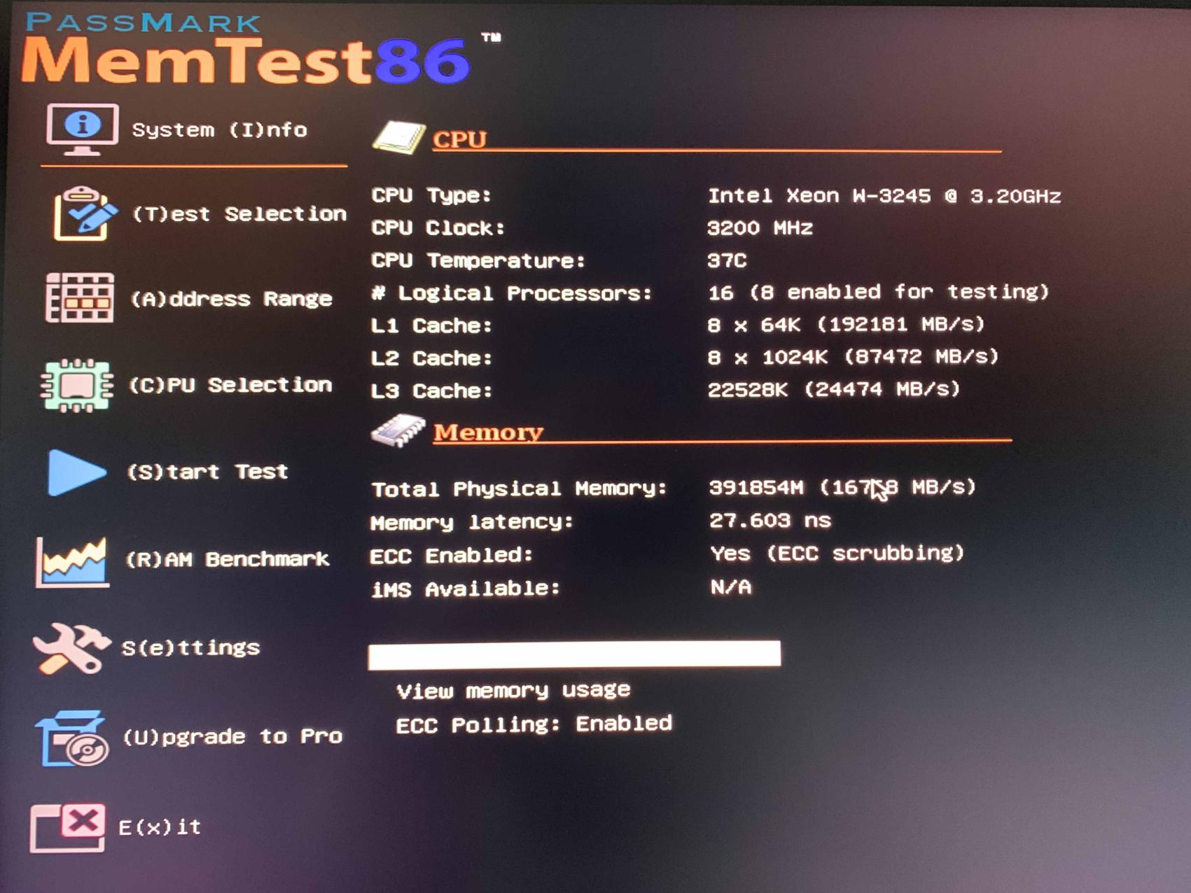

          • Paul2112
            • Jan 2022
            Hi David,
            I tested the proposed build. It has been necessary to disable Secure Boot, but I guess it was something expected.
            I believe now the ECC RAM is recognized, however, the memory controller seems to be reported as a skylake rather than a cascade lake.
            Is it something which is more convenient for your implementation or actually the platform is a skylake?
            Thanks.
            Paul

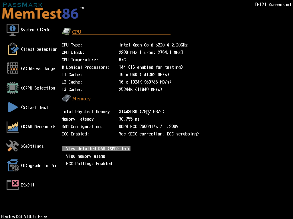

              Hello PassMark Team,
              I encountered the same problem with one of our servers. We have a Cascadelake CPU (Xeon Gold 5220) with ECC RAM, but in memtest86 v10.5 ECC shows as unavailable.
              Could you please upload a patched version again? Iif you need more information let me know.
              Thanks in advance​

                  • EDV Team
                    • Jul 2023
                    Hi Keith,
                    I'm sorry for my late response, I ran some tests overnight and your build worked! Thank you very much.
                    Is the Cascade Lake support generally not build into memtest86 or was this a system specific problem?
                    It would be great if this fix would find its way into the next memtest86 release, so others could also benefit from it.
                    Best regards
