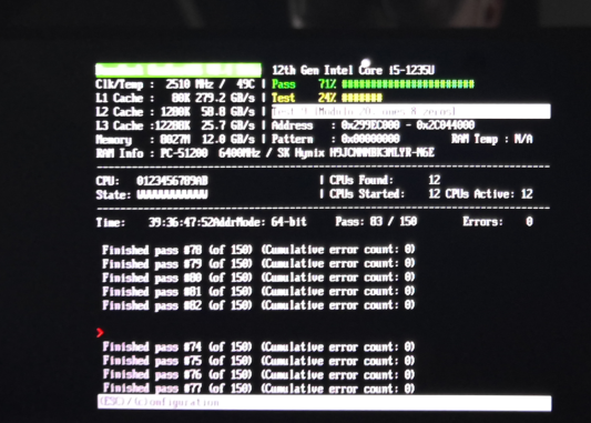

      I set 150 passes for 8GB memory, it should run more than 72 hours. But now it was stuck at 39 hours, and already passed 82 passes. Please have a look the below screenshot.
      I tried to run same test with a USB boot instead of PXE, it passed all 150 passes. So I only failed on PXE now. Do you know if there is any setting that we can have PXE running log for debugging? If any clue, please let me know. Thank you so much.

              Do you have screen shots from the other times this has happened? How close is the lockup time to the same second? I am wondering if it is some type of network timeout. Another possibility is that there is some type of resource leak related to PXE / the Network device driver in UEFI BIOS & eventually the driver fails.
              How many different machines have you tried this on? For example on a machine with twice the RAM does it take longer to lockup (indicating that the trigger might be in MemTest86 itself reaching a certain position in the testing (e.g. 82 test cycles)).
              No we haven't done 39+ hours test runs from a PXE boot (not in one go anyway).
              Also strange: The Time stamp value in your screen shot is also in a messed up format (39:36:47:52).
              Can you try significantly reducing the amount of RAM being tested via the config file (ADDRLIMLO and ADDRLIMHI). This should help if it is a resource leak,

                The lockup time was different with minutes for each round test, but all same at 39 hours currently. For example, first time it was stuck at 39:12:20, second round it might be stuck at 39:30:40, third round was stuck at 39:30:20, also it was stuck at a random test case.
                So far, I tried to test four machines, one Surface laptop, three Surface Pro. The config file of Memtest86 like the below.
                Let me try your idea to reduce the amount of RAM. Thanks.
