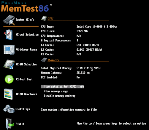

    Hi, I've been having various issues with my system, which I thought was due to a faulty GPU driver. I've started a thread on this over at AMD and they advised me to run a memtest86, which I did but it's since found nothing. BTW, here's the original thread I started over at AMD: https://community.amd.com/thread/170476
    I ran one pass with the memtest software and it found no issues and so I stopped it running.
    Another thing is that when I ran the memtest86 from the usb stick, I didn't get the interface above but it went straight into running the test? Could I have made an error here? Please advise. Thanks.
    Only machines that support UEFI will run MemTest86 v6 as shown in the screenshot. Because our images support dual-boot, for older machines that don't support UEFI, the older MemTest86 v4 shall be run (which doesn't have any graphics)
