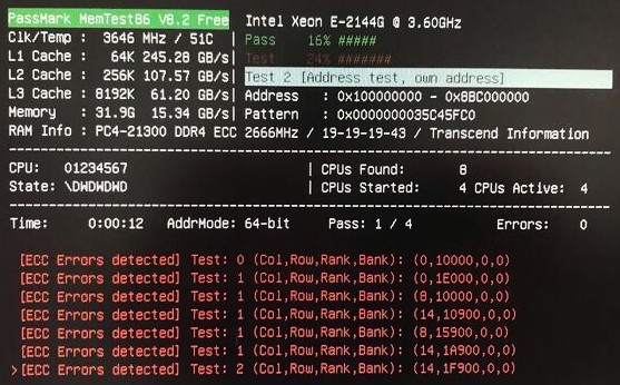

      The memtest86 did find some ECC errors with our other system before, but it usually shows the error address where it is. like the photo below

      However, with the Intel Atom C2000 chipsets, most of the ECC errors will show the address as N/A.
      That is why I am not sure if there have real ECC errors or not.
        There are many different hardware mechanisms for the reporting of ECC errors. Machine Check Architecture (MCA), Sideband registers for Intel SoC chipsets, etc...
        It is a bit of a non standard mess where everyone does their own thing. Not all of them record the location of the ECC error.
        See this page for more details.
        https://www.memtest86.com/ecc.htm
