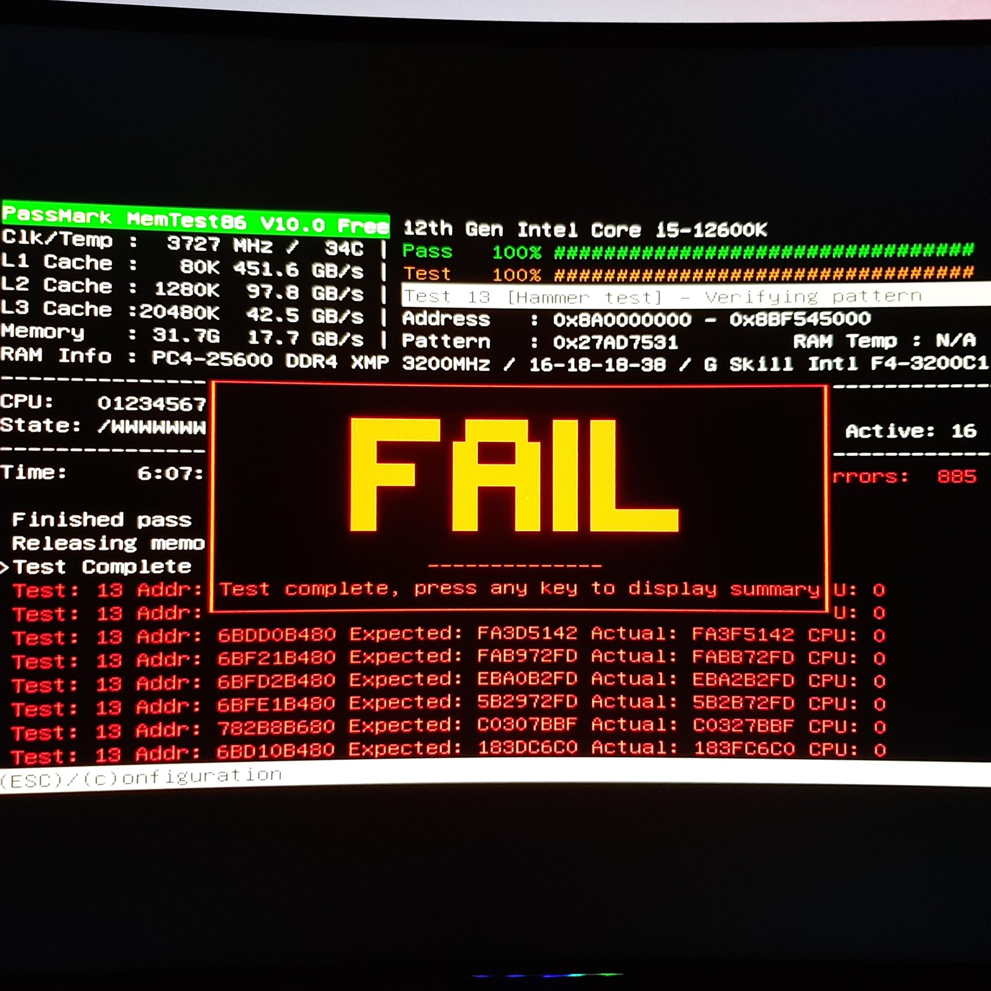

    As the title suggests.
    Completed the test but now keyboard and mouse are not functioning / test is seemingly frozen.
    How do I get past this point? Am I OK to force restart? Will it still produce results files that I can forward for advice?
    Would also like to ask about the results... been getting sudden and persistant BSODs, starting out of the blue 3 days ago.
    I can assume it is indeed RAM related? I have replacements coming but want to check if there isn't a wider issue.
    From the screen shot photo it looks like the RAM is bad.
    See this page to start with
    RAM that has a lot of errors can stop both Windows and Memtest86 from running smoothly.

      My system is still unresponsive on that screen... am I ok to force shutdown? Will the report files still save somewhere on my system?
      And I assume I should remove the USB once the PC is off and boot normally?
        There is a debug log that get written as the test progresses.
        So that should be on the USB drive. But it isn't really meant to be a end user readable report.
        It doesn't sound like the final (human readable) HTML report was written however.
        Yes, just power cycle the machine if it is locked up.
