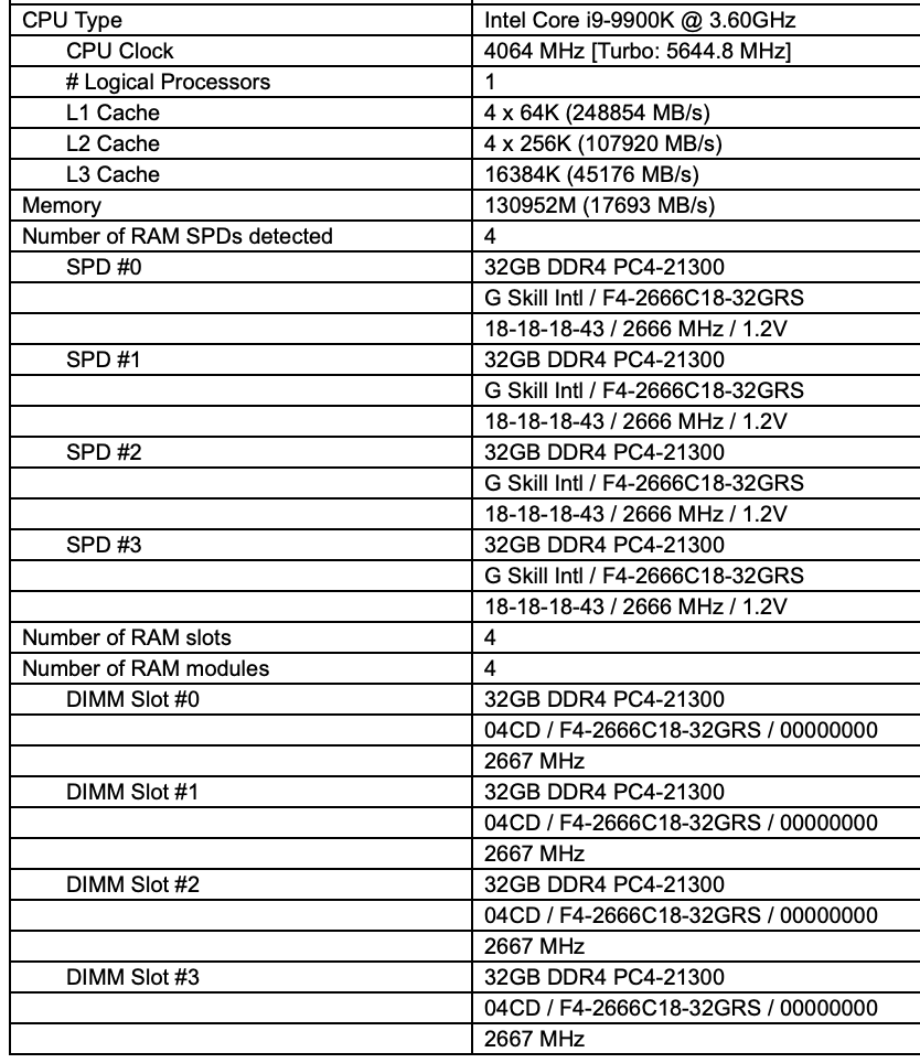

    MemTest86 splash page only recognizes the SPD module of the stick in the first occupied slot. For all remaining modules, it says "
    SPD not detected". This is independent of which slot is the first one occupied, and which stick is in the first slot. If slots 1–4 are occupied, it only recognizes the SPD info. for the stick in slot 1. If slots 2 & 4 are occupied, it only recognizes the SPD info. for the stick in slot 2, etc.
    However, when I look at the HTML report, it says the SPD modules are recognized for all slots (see screenshot below).

      There are a lot more specs for RAM that go beyond those 4 numbers. Voltages, clocks speeds and lots of timing values. The full specs are stored in the SPD data. There are dozens of different numbers. If this was a PC, I would say it would be fine, as generally PC BIOS is pretty flexible. However with Apple, no one knows.
      I don't see, in the HTML report, the complete set of SPD info. that MemTest86 reports on-screen. Would it be possible to get it from the log file, or is the only way to record it by writing it down with pen and paper?

              Can you send us the debug log for this
              Done! Emailed the log and HTML report to info@passmark.com. Please let me kmow if you find anything interesting!
                since I ran the test again and got 5 TB/s (!) for my L1 cache
                Got the logs. It might be 32bit overflow error. This is very old code from maybe 20 years ago. We suspect a 32bit integer is overflowing on very fast machines. We'll rewrite this code in 64bit and see how it goes.
