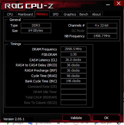

          I'm running memtest v10.5 on a Ryzen 9 7900X with RAM set to DDR5-6000 in the BIOS. During tests, memtest reports speed of 3734 MT/s x2 Channel. Is that as expected?

              The BIOS has enabled an EXPO profile to bring the RAM to DDR5-6000 (photo attached). With Windows running, CPU-Z shows the DRAM frequency as approximately 3000 MHz (screenshot). The memtest log is attached as well. Thanks for your help! Click image for larger version

                Thanks for the logs.
                We made some fixes to the memory speed detection for this chipset. Can you give this debug build a try:
                https://www.passmark.com/temp/memtes...-10.5.1003.zip

                      MemTest86 v10.5 build 1000 reports the speed of my DDR5-6000 as 3734 MT/s.​
                      I tried the debug build 1003, and the speed is shown correctly now.

                        MemTest86 never sets the RAM speed. It only reports on the speed set in BIOS and in the SPD configuration chip. So it is only a display issue.
