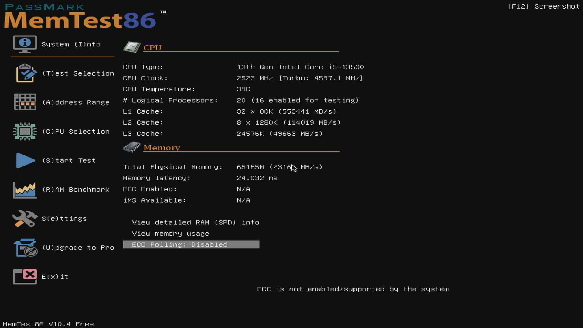

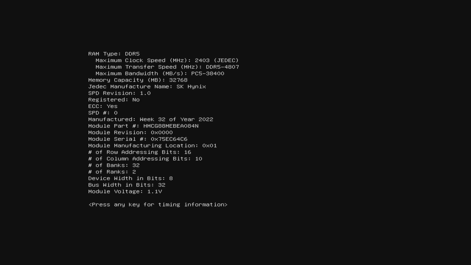

            Hi Keith,
            Also running into this issue with version 10.4. Do you know if those changes should be included now in 10.4 or not yet?
            My system is:
            Intel i5-13500
            Asus PRO WS W680-ACE
            Hynix 32GB DDR5 ECC​ HMCG88MEBEA
            When viewing the SPD info for each stick I see ECC: Yes, but on the main screen it still says N/A for ECC.

              Originally posted by drampelt
              My system is:
              Intel i5-13500
              We'll need to look at the logs to confirm. Can you send a copy of the MemTest86 log under EFI\BOOT of the USB flash drive.
              • drampelt
                • Jun 2023
                Yep sorry, here they are.
                MemTest86-20230608-004425.log
                  [ATTACH]n55261[/ATTACH]
                  Thanks for the logs.
                  Yes, the ECC capabilities for this chipset should properly displayed in our next public release V10.5 (should be in a couple weeks or so)
