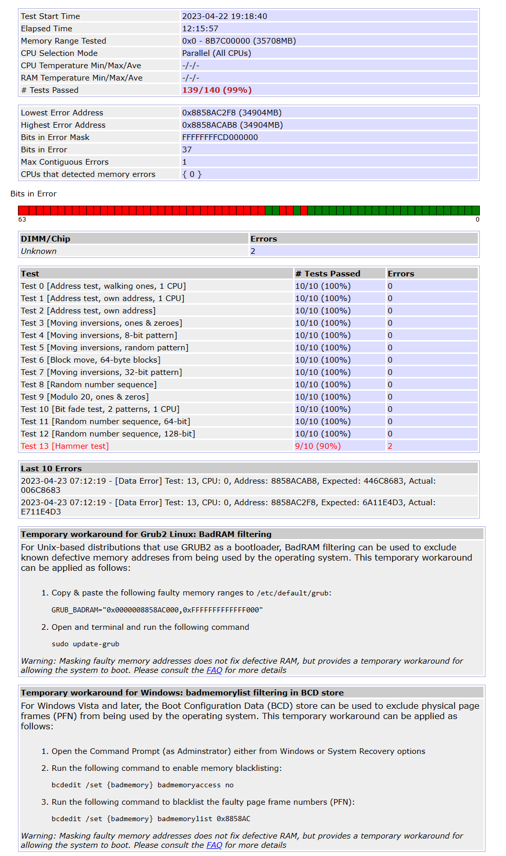

Please help to check the test result of Memtest86
    Hi Admin,
    I'm doing test using Memtest86 v10.2 site version, and my test environment was set up by PXE function. I found an error once at my first test, and could not repro issue after retest. So I'm curious what caused the issue, because of my test was working on PXE. Could you please help to check the error result if it's a real failure or it was caused by my network issue? Would you like to coach me something about the below failure? Thank you so much.

    Likely it is a real RAM issue.
    But the errors are only in test #13, the row hammer test. Which generally points to a design flaw in the hardware, or configuration issue.
    See.
    https://www.memtest86.com/troubleshooting.htm#hammer

      Thanks for your great help. I will try to repro if I can catch the same issue.
