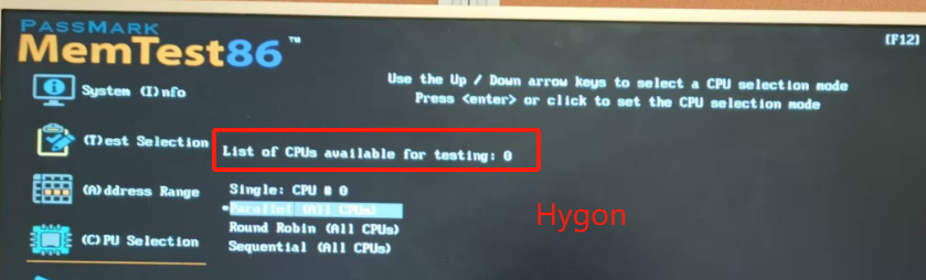

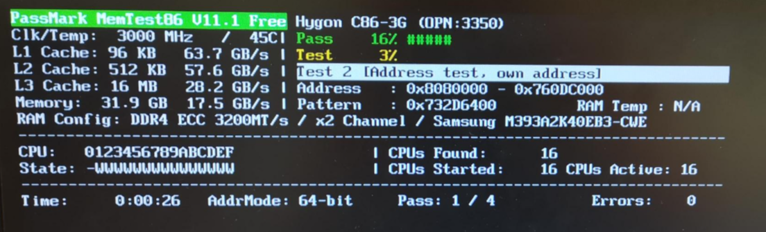

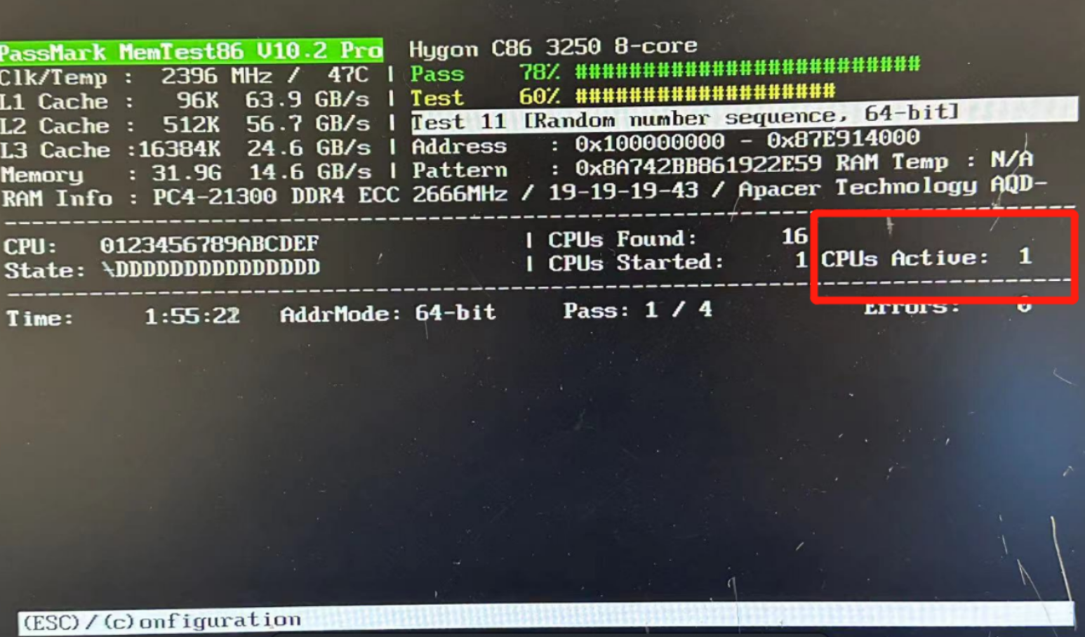

    Why memtest86 on Hygon platform will take a long time? I have tried testing memtest86 on Intel and Hygon platforms using four memory with the same capacity and frequency. The Intel platform only takes seven hours, but the Hygon platform takes twenty hours.
    And I found that the CPU Hygon C3250 is 8 core and 16 thread, but CPUs started and acvite are only one.
    Thank you for taking the time to answer my question~

    Likely the UEFI BIOS on the Hygon platform doesn't support multi-threading.
    Also the Hygon CPU might not have the same memory bandwidth as the Intel CPU you selected (14.6 GB/s was the number reported, but the latest Intel CPUs are significantly higher, even the old i5-7600K can get to 21 GB/sec).

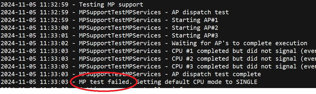

          The following is my debug log. Does it indicate that multithreading is supported?

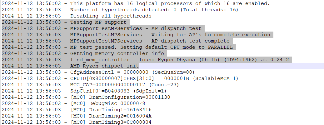

            Attached is the complete startup log. I see that multithreading has been tested and the CPU mode has been switched. Why is there still only one Active CPU?
            MP test passed. Setting default CPU mode to PARALLEL
              • 11127
              Yes, this line means the basic multi-threading / multi-process test passes.
              Code:
              2024-11-12 15:35:57 - MP test passed. Setting default CPU mode to PARALLEL
              But after that, the config file is processed and it seems you have set 1 CPU in the config file.
              Code:
              2024-11-12 15:35:58 - Applying configurations
              2024-11-12 15:35:58 - [CONFIG] This platform has 16 logical processors of which 1 are enabled.

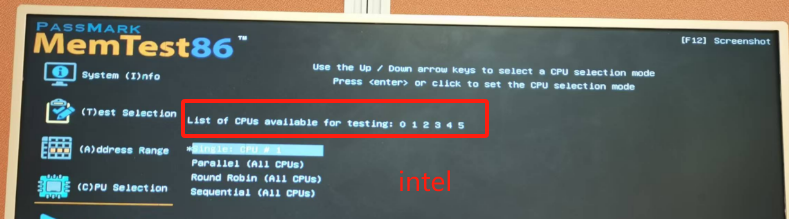

                    I noticed that the number of active cpus in the Intel CPU is the same as the actual physical core, while the number of active cpus in Hygon is only one.
                    So do you think this is a result of not having the right number of cpus configured under the UEFI BIOS?

                      • 11127
                      Yes, that isn't normal.
                      Looking at the logs again, it seems like the UEFI BIOS has disabled all the cores (incorrectly reporting CPU core enabled state​).
                      Code:
                      2024-11-12 15:35:56 - Proc 1 is disabled. Enabling...
                      2024-11-12 15:35:56 - Get Proc Info Proc #1
                      2024-11-12 15:35:56 - ProcID Enabled Type Status Pkg Core Thread Hyperthread?
                      2024-11-12 15:35:56 - 00000001 N AP 00000004 0 0 0 N​
                      "Enabled : N" means the core is disabled.
                      So still a BIOS bug.
