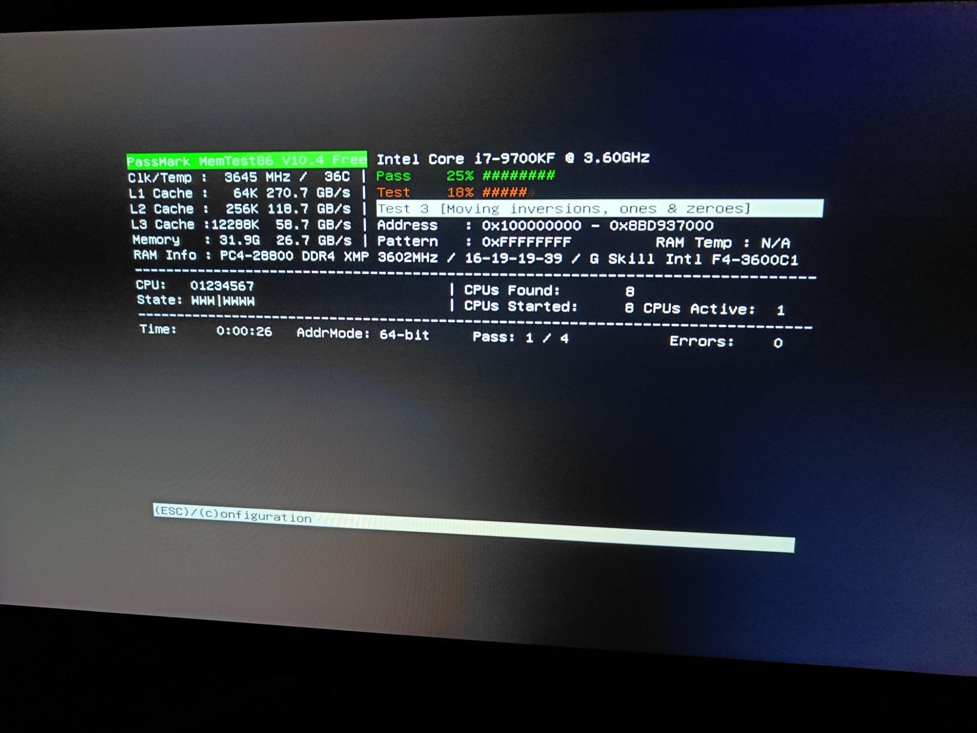

                  only 1 cycle is passed, as i said, no matter what i chose (cpu core count, testing method like hammer or or so it shows 1 cpu) reformatting does nothing, it doesnt want to revert to defaults.
                    cant change cpu cores and that pass time "1".

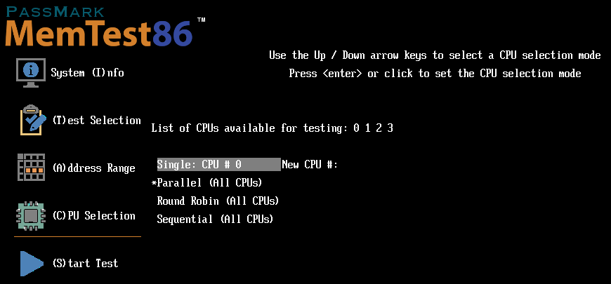

                        If you go to 'CPU Selection', you should be able to change the CPU mode to 'Parallel (All CPUs)
                          when i change to parallel, it still shows 1 cpu core.
                            Maybe you can post a photo of the CPU selection settings in the config menu?
